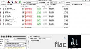

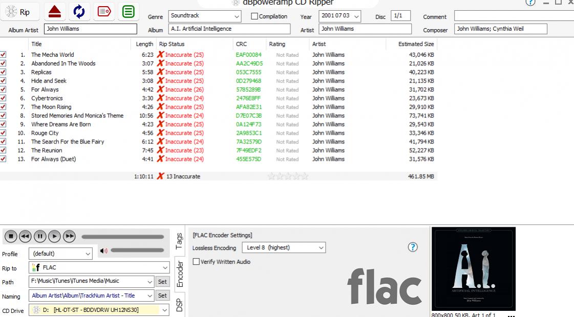

    Just like the title says (see attachment for details). Stumbled across this software as a way to rip my large collection of movie scores as I'm sick of iTunes ripping. I am using a LG UH12NS30 and have tried everything from updating the firmware on my drive to changing all the ripping/compression settings. Only this program produces the popping sounds. Playing in the drive directly in window media player is perfect. Playing the ripped files from any other ripping program is perfect. I love this program and how it works and I'm just at my wit's end. If anyone has any advice, please let me know.

        A few questions, if you don't mind.
        1. In what software are you hearing the popping sound.
        2. To confirm, you are ripping to the flac file format?
        3. Is the drive AccurateRip Verified?
        4. What DSPs are you using, if any?
        5. Is the result the same, if you un-tick C2 Error Pointers for Error Detection?
        6. Is this behaviour the same for any CD?
