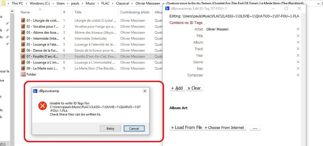

    I have ripped a CD (Olivier Messien's 'Quatuor pour la fin du temps').
    8/9 tracks have ripped fine. However, track 7 seems to be causing a issue. I have never experienced this error before:
    In short, all tagging fields for Track 7 remain blank, and when I try to complete them, the above pop-up appears (ie. 'Unable To Write ID Tags For ...').
    Many thanks in advance for ny kind assistance offered here.
    Cheers,
    Paul

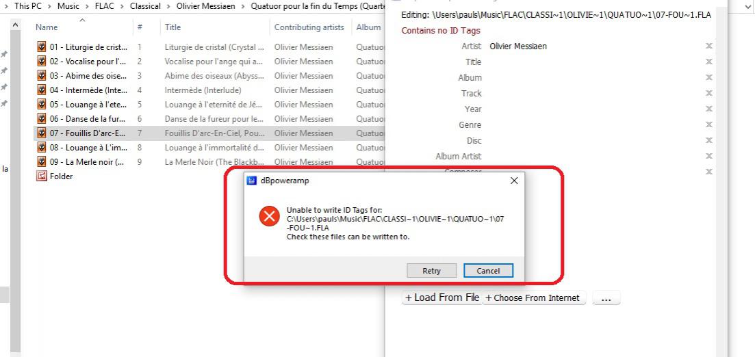

        Hi again,
        It likely means some other program has the file left open, try restarting your computer.
        I still receive the same error!?:
        • Jailhouse
