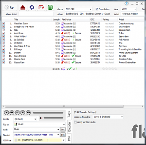

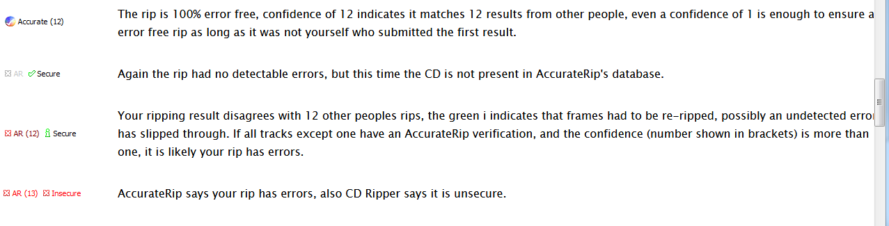

    I can't seem to find a comprehensive document describing all possible rip-status values and what they mean. The closest I found was the following URL https://www.dbpoweramp.com/help/dmc/CDhelp.htm. A screenshot of the relevant section of this web page is shown in the first attachment.

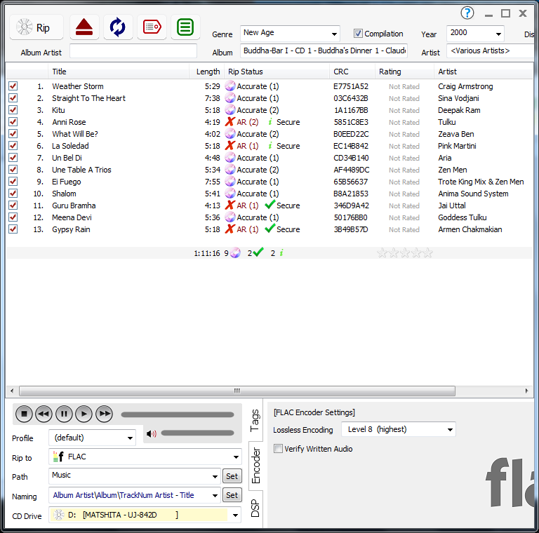

    The result of secure ripping "Budha Bar I - CD 1 - Buddha's Dinner 1" is shown in the 2nd attachment. Meaning of the rip status for track numbers 11 and 13 is not documented in the above online resource. What does this rip status mean?
    The 3rd attachment is the log file created by the CD Ripper. Could someone please explain how to interpret this file? What are the various CRC numbers described in the log file. Why do you have differing number of CRCs noted for different tracks?

    As the AccurateRip Confidence is low (2) you cannot be sure if your rip or the others had issues. Rerip those tracks, if the crc changes then for certain one of your rips had errors.

        The OP's status screen shows some tracks as inaccurate but secure with an "i" and some tracks as inaccurate but secure with a check. What's the difference between the "i" and the check?
        Also, I've ripped tracks as secure but with a "(warning)". What's the "warning" about?

          It means some tracks had bad frames which were re-ripped, a sure sign that there are disc issues.

                      Ok, thanks. So then what's the difference between rip status "AR (1) 'i' Secure" and "AR (1) 'check' Secure" in the OP's rip status? Wouldn't both imply that their rip disagreed with another person's rip, so there are likely errors in both files?

                        The Secure ripping possible display values are described in the help: dBpoweramp CD Ripper
                        For 'i' Secure, the green i indicates that frames had to be re-ripped

                          Thanks, mville, but that still doesn't quite answer my question since the possible display values shown on the linked help page (which the OP posted already) don't illustrate one of the values the OP posted, which I'm asking about, - which is, "AR (1) 'check' Secure". A couple of his ripped tracks had conflicts with AR, but were also declared secure and had a green "check" (not a green "i").
                          The only instance of a green check illustrated on the help page is one where a track wasn't in AR but ripped with no detectable errors. That makes sense, but how can a track rip with a conflicting AR value (implying errors), but also display a green check (implying rip with no detectable errors)? Thanks.

                              Different pressings can be in AccurateRip (outside of the pressing detection range), so every track could not match AccurateRip, yet be ripped correctly (if your disc has not been submitted).
