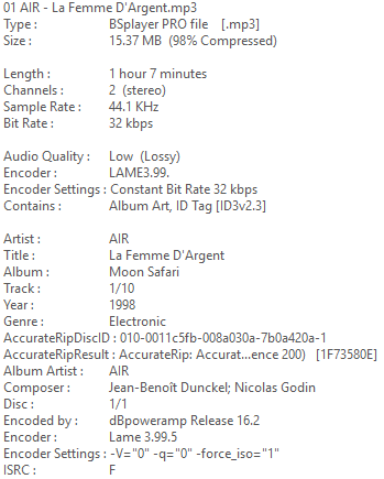

          I did indeed. v16.2. I changed a few settings from default, mainly to up quality and also had to set iso compatibility mode.
          Here is a good example, the track is actually 7m2s...

            Re: Track length showing incorrectly on mp3 rips - VBR issue?
            and this mode forces no VBR header. That is the issue.
                Compatibility mode is a very simple form of mp3, it could be there are other changes, or constraints on the mp3 bit buffers, I have not looked into it. You would have to re-rip to add the header.
                CBR does work fine, in compatibility mode, however you should never select this mode unless you had a 15 year old player which would not play modern mp3 files.
                VBR headers are not part of the official mp3 specification, so nothing is broken by not having the header.
