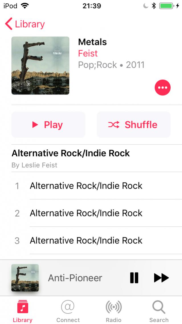

    I recently ripped a big bunch of CDs using multi-encoder (FLAC and mp3). The FLAC files are fine, but there's something up with the mp3s... they seem ok in iTunes, but when I sync onto a device (iPod with Music app, iOS 11.2.1) the album names are ok but the track Titles have all been replaced with the 'Style' tag (which I didn't know even existed until I went back and checked the ID tags on the file).
    When the track is played, however, the Music app shows the correct title in the player. The tracks are also out of order.
    See screenshot attached

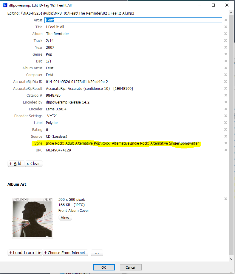

      Many thanks mville, that first link helped. iTunes was picking up the 'style' tags and using them in 'title'. When I delete that tag from the mp3 file, everything works fine. I'll go in and delete the field from all the files, which is certainly better than re-ripping.

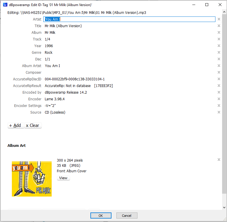

      My next question ... how do I get rid of the 'style' field for future rips? I checked my old rips and it wasn't on those (see below). It also doesn't appear in the editable meta-data for tags when ripping, and I can't see any options in CD ripper. Any ideas?
      Old rip:Click image for larger version
Name:	Old rip (2012).PNG
      New rip: Click image for larger version
Name:	New Rip (2017).PNG
