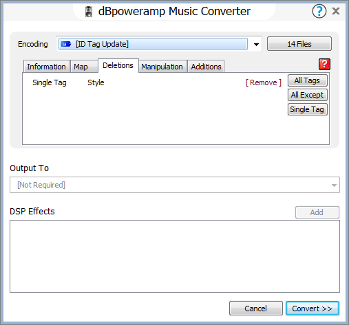

                          this is the setting
                            #28
                            Re: Apple Music Problems With iOS 11 & iTunes 12.7
                            Your files might be read only, check they are writable and the location they are stored on has write permissions for your user account.

                              sir,
                              besides the, what you suggested, "You would not have ‘Clear Read Cache with FUA’ set for your drive."
                              are my other settings ok ??
                              • Hitarth
                                • Sep 2017
                                • 226
                                #30
                                will try these files again .... in the mean while, some files in another location did well ... thanks
