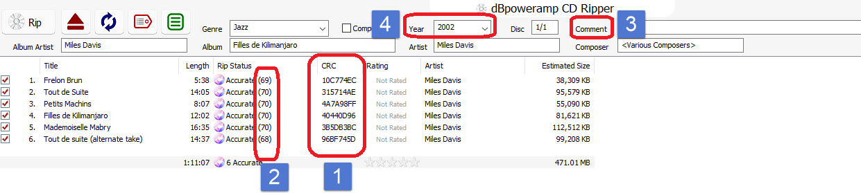

                              #59
                              Hi again,
                              (Please see screenshot.)
                              1 - Is the 'CRC' alpha-numeric code related to the check-sum, or is this completely different?
                              2 - Are the numbers (69~70) after 'accurate' related to how many online results (found) AccurateRip has cross-referenced the (my) rip against?
                              3 - Do you fill in anything in the 'Comment' field (I have left this verbatim empty).
                              4 - If the ORIGINAL (LP) recording session was 1968, and the date showing for the (remastered) CD version is (in this case) '2002', then do you change this date back to that of the original recording (ie. 1968)?
                              Many thanks in advance for any kind assistance offered here.
                              Paul
                              • Oggy
                                • 703
