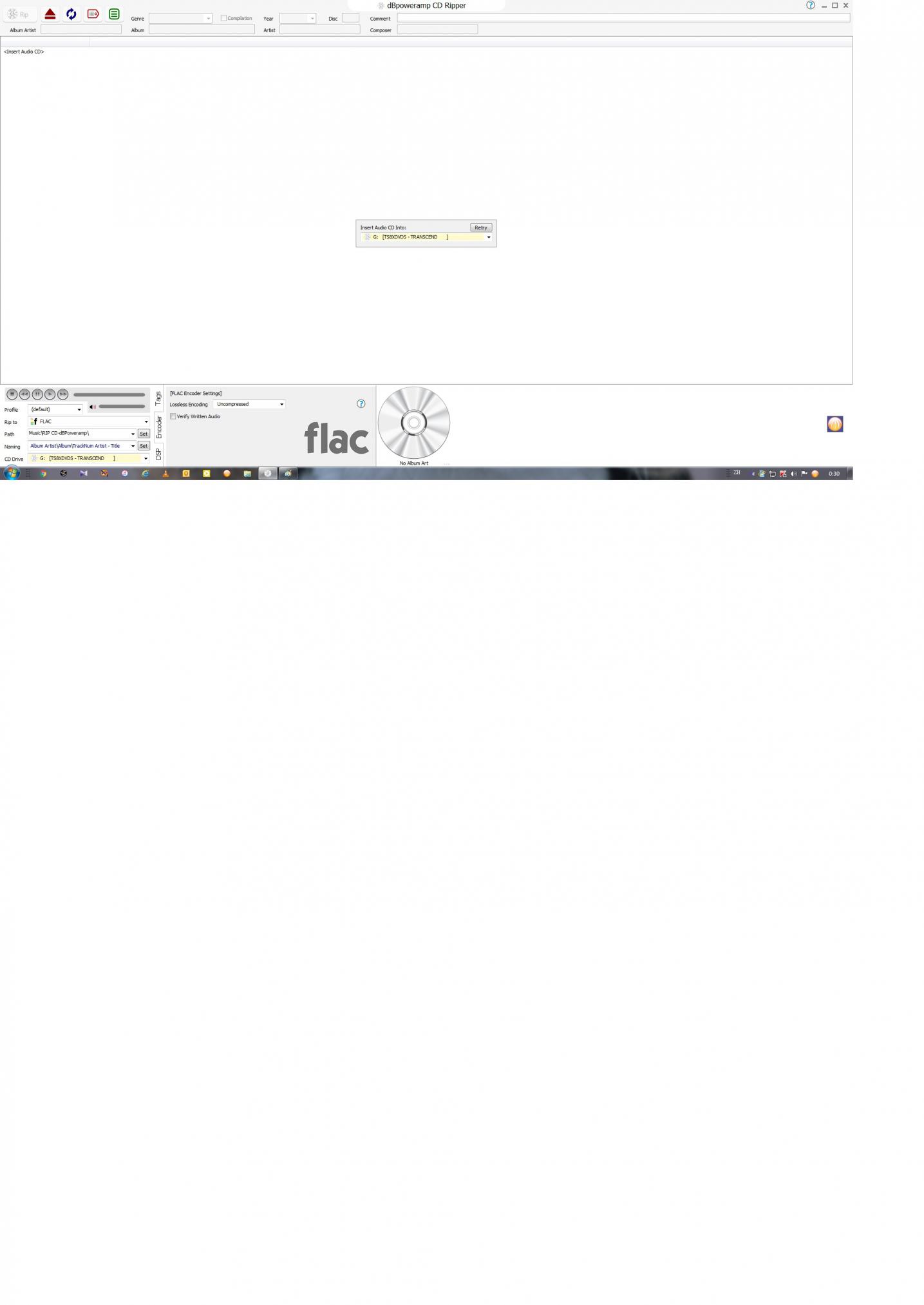

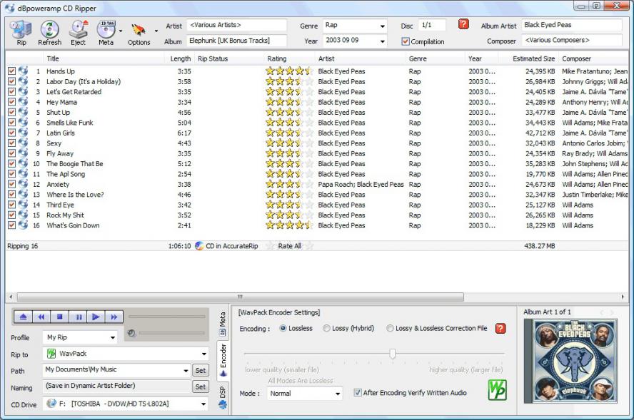

      Please see the attached pictures:
      One is the trial version I'm using now
      Another is a registered version's picture (I believe it is registered version) that I download from internet
      If you look at their icon on top, there are a lot of difference.
Name:	Register Version.jpg
ID:	293361Click image for larger version
Name:	Trial Version.jpg
        • 1914
        Re: Trial version vs Registered version dbpoweramp
        The picture "Register Version.jpg" shows the old (up to R15), but not the actual version (R16) of dBpa. The actual registered version looks like the "Trial Version.jpg".
