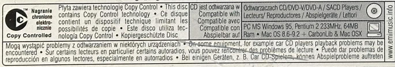

          I recently visited a local thrift store and browsed the media section and noticed a CD that my friend would like so called him and he said get it. Ok, so of course I will add it to my collection of ripped discs and noticed a weird thing. The CD has absolutely no scratches on it but during ripping each track shows up as insecure. I tried all the methods in dht dbpoweramp ripper but the only one that created audio that was not glitchy and playable was burst copy. The tracks still showed as insecure but had no audible defects. After ripping I looked at the CD case and noticed it had a weird logo I have never seen. Shown below is the entire copy protection section from the back of the CD. This is a Polish band CD so both languages are used. To my brief research very few production companies used this protection and EMI and Virgin are the ones I seen the most mentioned.
          Click image for larger version  Name:	2024-09-27 10.02.59 crop.jpg Views:	0 Size:	82.1 KB ID:	328124
          Another weird thing is that I don't see any logos anywhere on the printed inserts mentioning Compact Disc Digital Audio because of the copy protection this CD does not meet Red Book standards. What I am getting at here is this. How is this CD in the AccurateRip database? I think the copy in the database is from a non copy protected version but the CD ID must be the same. Every track I ripped shows as insecure. The CD is completely undamaged. The ripped mp3s sound perfect. I had to use the burst rip setting during ripping as the secure one took overnight to rip and then all I had was error on each track shown in dbpoweramp ripper. One thing I also tried was 3 different drives and all of them were external USB portable drives. 2 of them created 11 tracks which is what the CD actually has, 1 created 12 tracks and the last track was 29+ minutes long and had the first several tracks all together in the 29+ minute segment. So basically I would like to know why the AccurateRip database has a single entry for this CD but obviously multiple versions exist and I believe the one in the AccurateRip database is not copy protected otherwise it should not be insecure as the CRC would match assuming the CD in the database is not physically undamaged. I thought that each version of a released album has its own CD ID. Also, I have a feeling that whoever originally purchased this CD may have been experiencing problems playing so it ended up in this store. I don't know.
