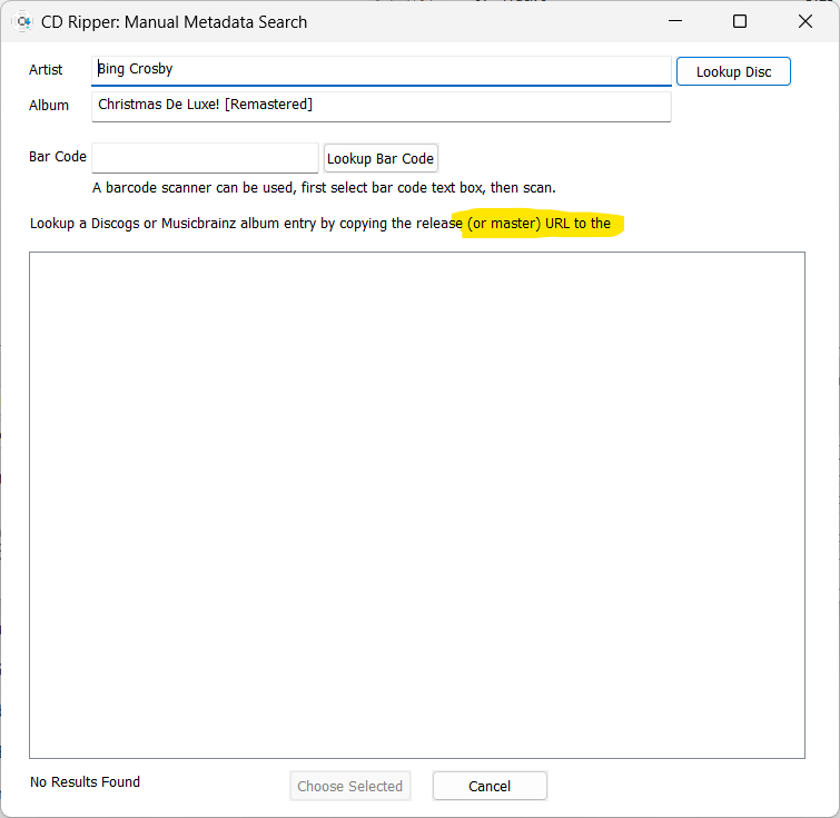

          Also, regarding the attached, are we missing something? Like a complete sentence?
Name:	Screenshot 2026-09-07 174221.png
            Update to the new release of dbpoweramp
            • channel27
              • Jan 2017
              • 24
              I'm running 2026-05-25 and it's reporting "No update required"
                It caches the update for a few days, if you click on the days left of updates, and then Ok on the page where you set the order number, it will lookup live.
