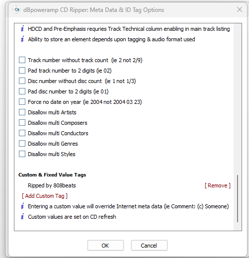

          I tried the DSP ID Tag Update, see attachment, but it didn't work.
          Maybe I'm missing something basic?
            The ID Tag Processing DSP only adds when ripping, it does not add before ripping (that can be seen in the tags list). Instead use my suggestion.

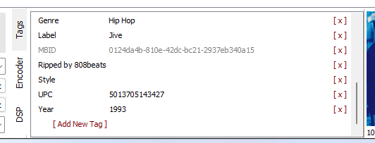

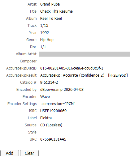

              But it wasn't adding it to the finished file after ripping, that was my point.
              I've just checked at the end of the options page as you suggested, and it was already filled in with my preferred comment.
              But this info isn't embedding into the final file, see attachments.
                Did you click refresh? if the disc was taken from the metadata cache it will not populate. Click refresh for any previously viewed discs.
