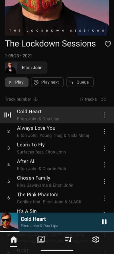

      Artist: Elton John, Young Thug & Nicki Minaj
      Artists: Elton John; Young Thug; Nicki Minaj
      ArtistsSort: John, Elton; Young Thug; Minaj, Nicki

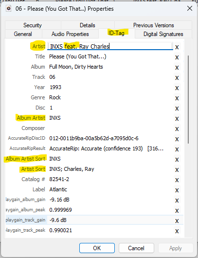

            After ripping a test version of the song, I found the flac file on my computer hard drive and right-clicked on it to view the Properties. There was a tab called ID-Tag, which you can see below in my screenshot. Before I ripped, I manually changed the Artist for the track to "INXS feat. Ray Charles" and then I added the Artist Sort tag (since it had disappeared) and manually typed "INXS; Charles, Ray" and then pressed the rip button.
            There wasn't an Artists or ArtistsSort option available before ripping, nor did one appear after ripping. I think you are saying I would have to do the additional step of using MusicBrainz Picard to add the plural version of the tags. If I don't do that extra step, then what will happen in most players with the tags I have below? When I view the list of all my artists, will there be one for INXS and another one for Ray Charles (sorted in C) or will he be listed the way it was typed (Charles, Ray instead of Ray Charles), or will the list show an artist for INXS and another artist for "INXS feat. Ray Charles"?

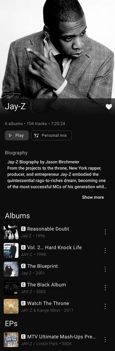

                  Showing different release types and the collation of albums across name changes i.e. Jaÿ-Z -> JAY-Z -> Jay-Z -> JAY Z.

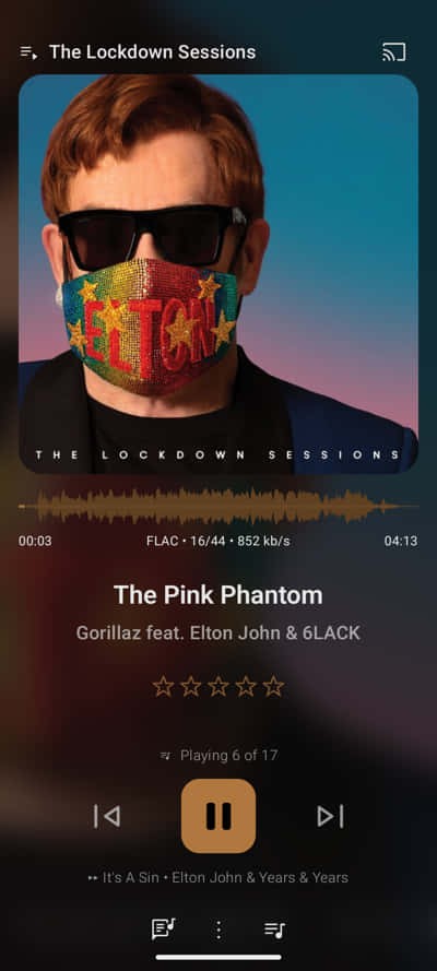

                  This is the Now Playing screen. Clicking on "Gorillaz feat. Elton John and 6LACK" brings up a list of the individual artists that will take you to their artist page (as above).

                              Thank you. I was able to right-click on the files and see the ID Tag info. Seeing what the tags look like really helped me understand it a little better.
                              vilsen Thanks. The Display Artist tag would make it easier for me if all players used it.
                              I might have to keep it simple (such as using "INXS" as the Artist and ArtistSort for that one song instead of trying to add the featuring artist) for most of these scenarios. Then I could use something like Picard to add detailed tags in the future?
