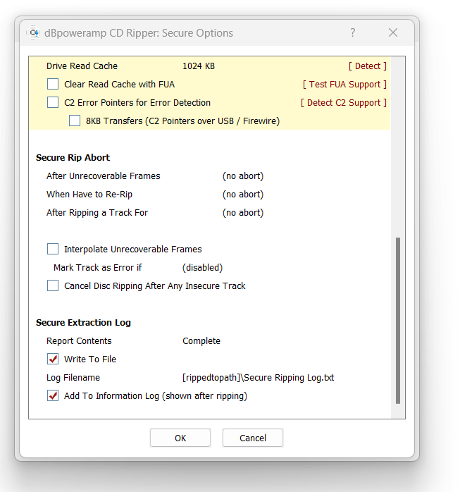

          When I click on Menu, I see an option for After Ripping. The first 2 options are Display Error Log and Display Information Log. There isn't a "?" to see what it means, and the only thing I can do it add or remove a checkmark (I can't make changes except turn on and off). Are these logs that are stored on my drive, or is this just an info screen that appears on my monitor telling me the result. I can't find anything else related to log settings except what I described.
            • 6189
            In CD Ripper Options, Secure Ripping options, at the bottom see the two items I have ticked (and I have selected "Complete" for the report contents. This saves my logs in the same folder as the album tracks. If I don't tick these, nothing is saved, but I would still see a DISPLAY only at the end of the ripping process.
