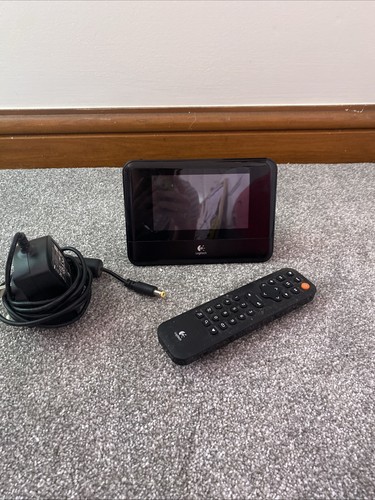

      3. Next to your computer install one of the following:
      a. used Squeezebox TOUCH (this would be the BEST thing to get in my opinion....)
      (looks like several available "new in box" from ebay UK:

          Had to read a few times-but Think Ive got most of it....A couple of Questions (as always.)
          1.Ive Downloaded LMS. no problem. When it Scans for music Can I use an external HD AND/or Internal one (which would you advise...??) My internal holds 1tb...But could put more in Computer...
          2. I like the Squeezebox touch... Can I plug in and play on purchase.(DOES IT HAVE A INTERNAL DAC) can I get A better DAC LATER...?

              1. use either internal or external. doesn't matter.
              2. Yes, Touch has a good internal DAC (or can feed a dac). Touch has analog outs, or two digital outs (optical or S/PDIF). And with a piece of free software, it can also feed a USB DAC. (I've done a blind test on a TOUCH alone vs TOUCH connected via S/PDIF coax to a Benchmark DAC 1 and couldn't tell the difference.
