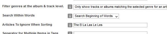

      Is your reason related to how a player/server menu reports the artists. For example, the players/servers I use have a setting to ignore the "the" in alphabetic listing of artists. Thus "The Beatles" shows up under the Bs, The Cars shows up under Cs, etc. You may end up crippling your metadata (by not using actual artist names) only to find out later, you wish they were correct because you now use players that deal with the "the" (or "a", "los", etc.). See pic for example from my LMS server feeding my squeezeboxes.

          Don't forget there is also the Artist Sort tag, which, if supported by your player, solves these issues: Artist: The Beatles; Artist Sort: Beatles, The or Beatles, or whatever you want without messing up the Artist tag.
