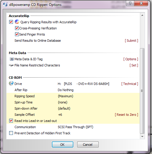

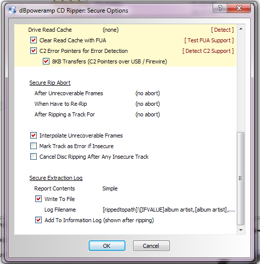

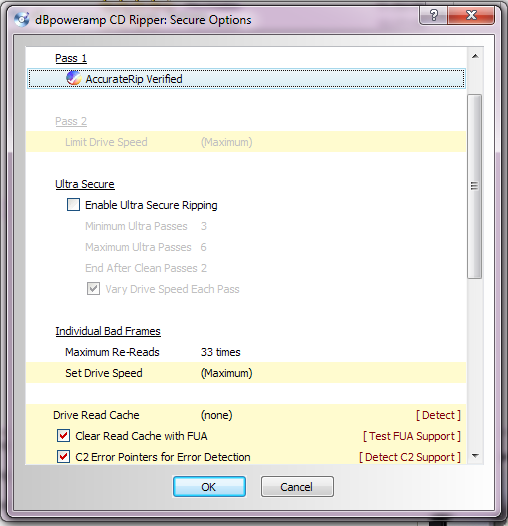

            Re: re-rip and frames countdown. What is that?
            Define "configured". I have gone through the initial setup, option per option, and done all the tests and "detect" and things I could find.
            Accurate is selected now.
            I attach three screens.
            Tell me please if I should do other tests.
            As I have edited above just before you wrote, 27min and it was just the half of the countdown? One single song? vs 10min complete CD with accurate rip in EAC?
            There MUST be something wrong.
            You can see in the last screen I think, that I have the 8k option active, because I use my sata dvd drive in an external case with usb cable. I have a notebook where I have installed a second HDD where the dvd was.
            Anyway, this does not create any problem in EAC. And, with 8k option disabled the result in dB is the same.
            I could go through the hassle of opening the notebook again (dell, can be done) and put the dvd back in place and see if the rips are faster, although then I will have the HDD (where I am storing the rips) external in usb, so, no idea what is better...

              I forgot the screens:
ID:	293088Click image for larger version
ID:	293089Click image for larger version
              Just to be clear, my drive supports C2.
              And in EAC I also have accurate rip, secure, and c2 all active.
              I hope I can solve this (without sacrificing c2 and secure ripping!) because I was happy that dB was ripping some CDs in 1/4 the time than EAC.

                        Ok, I have installed the dvd again inside the notebook, after all in this moment I am ripping a lot and it makes sense to have a better performance on the dvd than on the HDD.
                        And I have done all the detecting on dB again.
                        With surprise some results were now different. Which shows that the same drive does not perform the same when directly internal in sata or external in usb.
                        And it is not only a matter of amount of data.
                        For example, take the screen 2 a few posts above. There was no detected cache, and the FUA had been detected and was active.
                        Now a 75kb cache was detected and no FUA.
                        C2 was once again detected though.
                        I have done that same CD and there was no frames countdown now.
                        So, problem solved.
