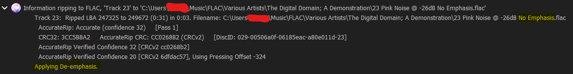

            Hi All,
            I re-ripped the CD that was giving me issues, and it appears that the CD Ripper is applying de-emphasis to tracks not marked with pre-emphasis. Most tracks on the album have pre-emphasis, but quite a few at the end do not. The only setting I have set in the ripper settings is "apply de-emphasis to CD tracks marked with pre-emphasis."
            Spoon, I took your advice and compared the CRC value for this rip (Release 2025-07-21) to the one I made on Release 17.7 with this result:
            CRC32 ; MD5 ; AccurateRip CRC ; Filename
            D4D8355C ; DEEAE44D0761BEF8CCE2A0E7359650EA ; 8D411B1F ;
            C:\Users\XXXXX\Music\z Test AccurateRip Folder\Pre-Emphasis Tests\Test 4 - The New Rip - No Emphasis\2025-07-21 - 23 Pink Noise @ -26dB No Emphasis.flac
            3CC5B8A2 ; 33984F3FD0DFBBF2A0E3917C4D66E135 ; D5393594 ;
            C:\Users\XXXXX\Music\z Test AccurateRip Folder\Pre-Emphasis Tests\Test 4 - The New Rip - No Emphasis\17.7 - 23 Pink Noise @ -26dB No Emphasis.flac
            Below I have images of more of my findings. I apologize if attaching images aren't permitted. I am still relatively new here.
            Initial Rip Result:
            This shows that de-emphasis was applied for the rip.

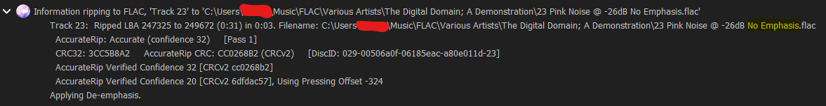

            Main CD Ripper Screen:
ID:	335816​Track 23 should not be having de-emphasis applied, as it is not marked as having pre-emphasis, which the ripper correctly identifies here. I included Track 22 for reference.

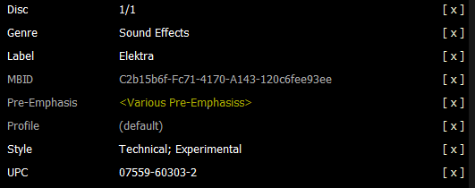

            Tags Window:
            ​​Is there a setting I am missing in the ripper options, or could this be a bug?
