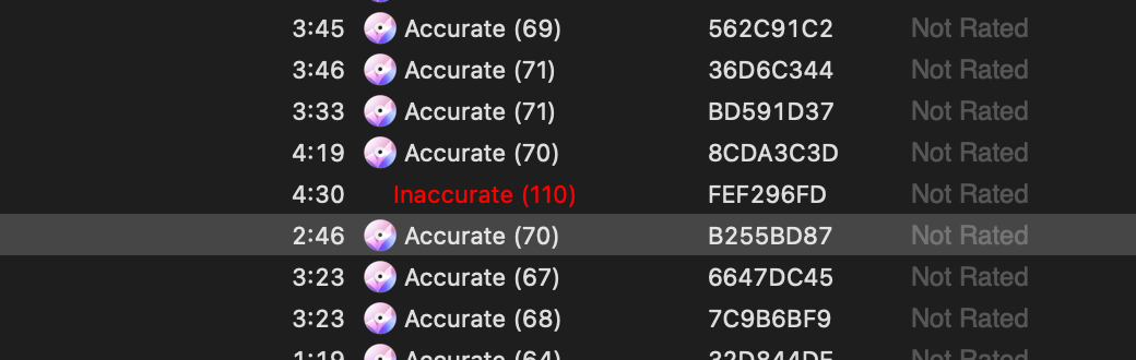

    Can someone explain this? If I read it correctly, there are 110 "matching" inaccurate rips of this track, and 70-ish matching accurate rips of the other tracks. It seems to me that if 110 rips are identical, that's accurate. Or even if it's just counting inaccurate rips with no regard to the CRC, why would the number be so much higher than the number of successful rips??

    Different pressing, when showing an inaccurate rip the it is not able to match against your pressing, there could be 5 other pressings.

      Thank you! So does that mean that the rip is so far from reality that the software can't even figure out what it's supposed to be matching? Or that it might actually be accurate but is incorrectly matching with the wrong pressing?
        No effort is put in trying to match a miss match, which ever pressing comes first appears. It could be we can try to find the same pressing, but it would not be 100% as tracks are individual, not grouped by pressing.
