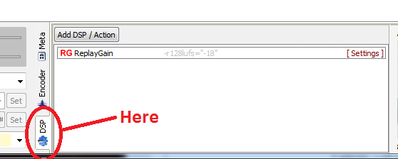

                              The ReplayGain effect was added in the "DSP" tab at the bottom of the main dBpoweramp window (Click image for larger version

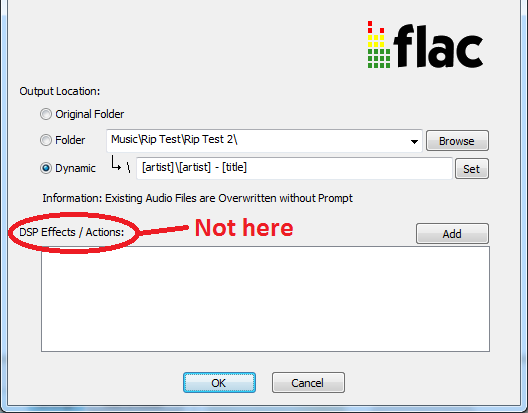

ID:	293079), not in the "DSP Effects / Actions:" field in the configuration window(s) of the encoder(s) (Click image for larger version
