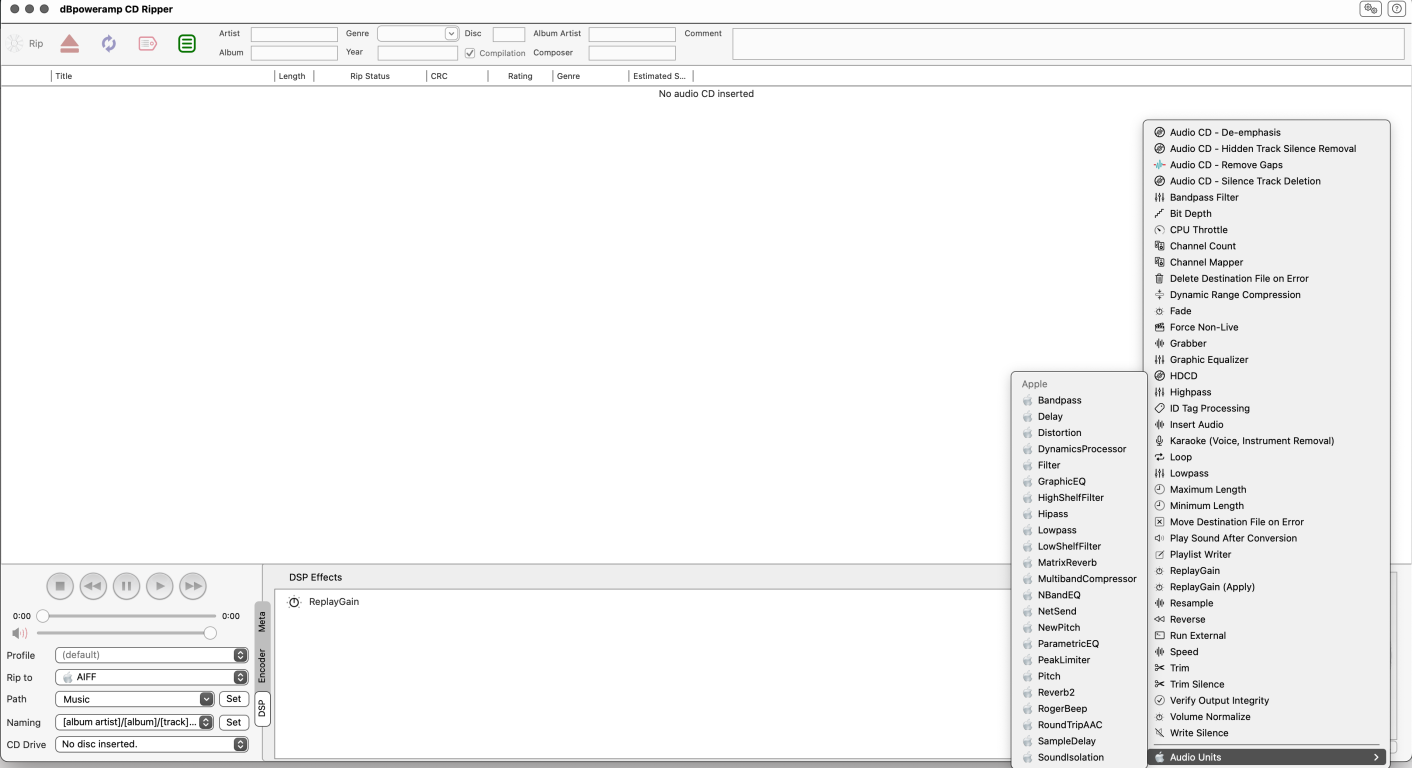

Name:	Screenshot 2025-08-27 at 12.13.43 PM.png
ID:	334796 Hi Spoon,
      thanks for your reply .... I can see place to select Replaygain (DSP Tab) but not ITunNORM see attached.Once selected should I select save to retain?
        • 6189
        Once you add the Replaygain DSP on the DSP tab, you then on that DSP tab, to the right of replaygain, click Settings. Then within settings the dropdown box for "write" will allow you to add "track and album gain and itunes normalization" note there are two options, both have track and album gain, but then either itunes track normalization or itunes album normalization. itunes can only deal with one or the other (track vs album) rather than either.
