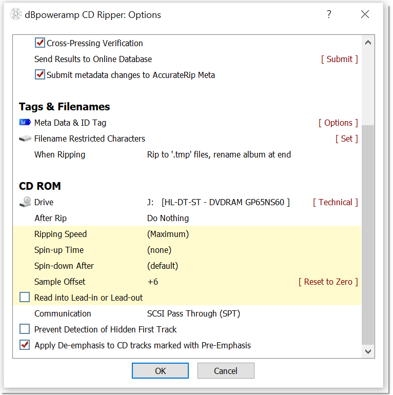

        Which Communication method is selected on the options page? (near bottom)

          The communication is SCSI Pass Through (SPT).
            It is an issue on your system, dBpoweramp regularly works with multiple drives through batch ripper and ejects the correct drive with the same communication method.
            You could disable the other cd drive in device manager.

                They will use a different communication method, you can set 'Built-in (Limited)' but all the C2 pointers will not work, if you were not using that.
