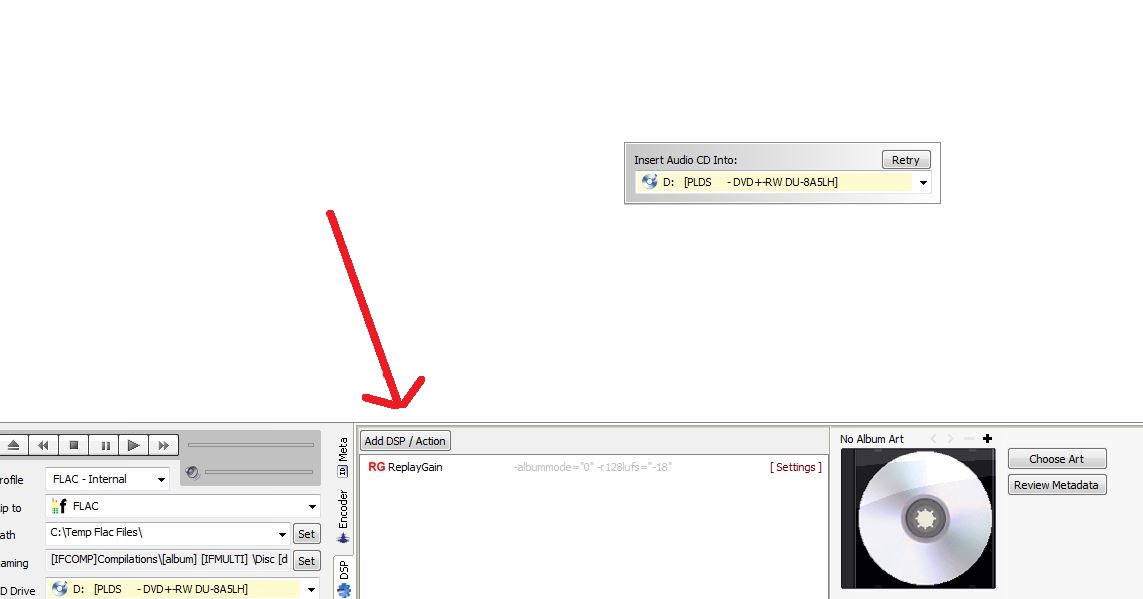

    Are you sure you didn't have the ReplayGain tag turned on when ripping? It would be the RG DSP in your ripping settings (DSP tab the lower center section of the ripper main screen). Also, note that adding RG tags is just adding a tag (that can be used by RG aware players). Adding the RG tag does NOT normalize volume or otherwise change the audio you extracted with the ripper.
      Re: ReplayGain in mouseover info
      see picClick image for larger version
        see pic[ATTACH=CONFIG]772[/ATTACH]
        Thanks for the reply. My mistake, as it turns out.
        After I ripped the CD, I had run it through a separate program, called MP3 Gain. I just did that to run the Analysis to see if anything was clipping. Nothing was clipping so I didn't apply any changes. Nevertheless, just running the analysis was enough to cause that notation to appear in the mouseover text. It had nothing to do with dBpoweramp after all.
        Thanks again!
