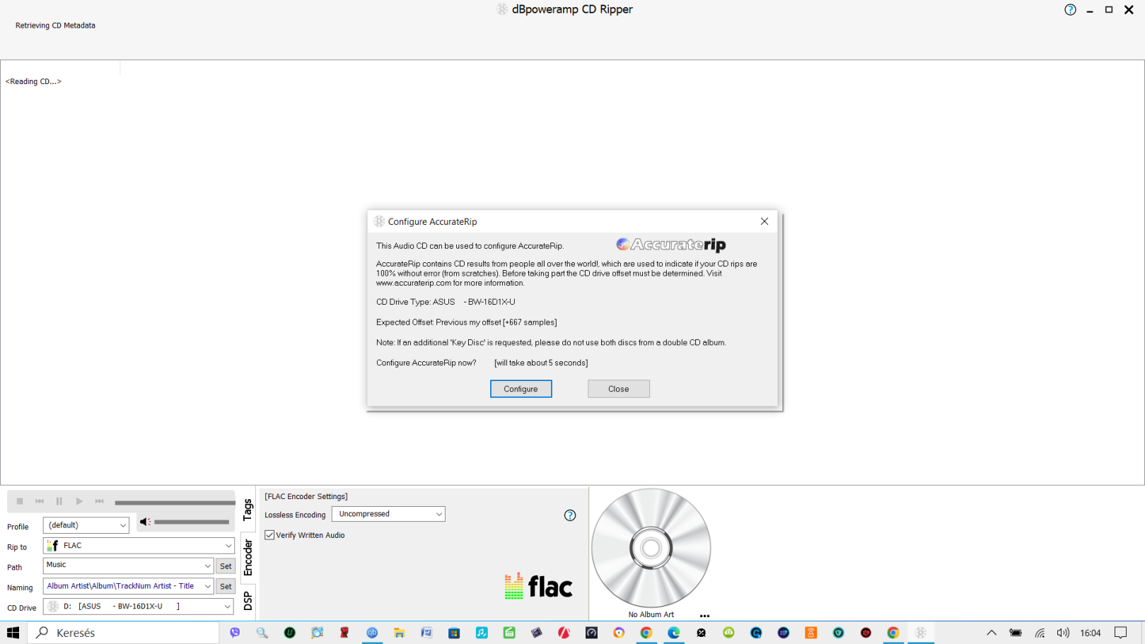

    I bought the dBpoweramp CD Ripper software yesterday.
    When ripping a new CD, the message shown in the first picture appears.

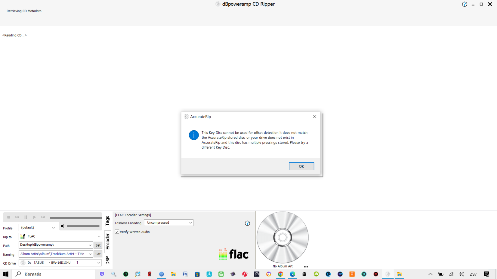

    I can't configure AccurateRip because it always says what is shown in the second picture.
    I tried several legitimate, factory CDs, but that didn't help either. It rips the disc, but this AccurateRip Configure procedure doesn't work with anything.
    What should I do? (I apologize if I didn't find that this topic has already been discussed on the forum.)
    Thanks in advance for your help,
    Peter
    Keep feeding discs and eventually it will configure.
    It is likely your drive is excluded from the configuration database because it has an offset which changes based on firmware, getting a different drive, not that model (and it would configure on the first disc).
