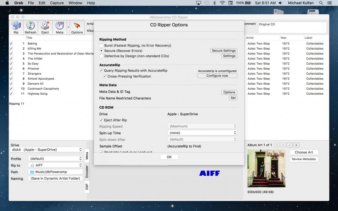

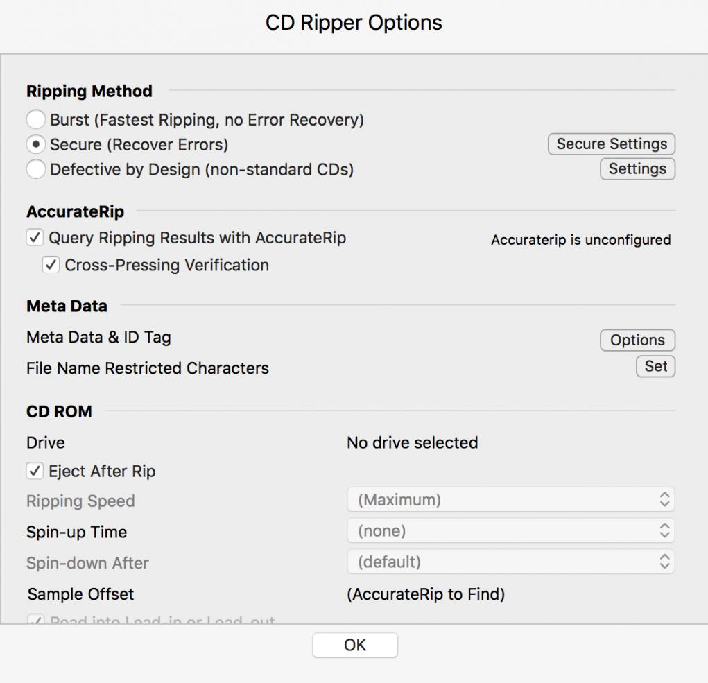

    I upgraded my Mac OS to El Capitan yesterday. Today I ripped 4 CDs just as I have done since I purchased the product. The problem is that non of the rips were Accuraterip. All used Secure and UltraSecure mode. All of the CDs are in perfect condition. I tried using XLD on one and it gave an Accuraterip result. I then went to Preferences and although the Accuraterip box is checked next to it it says "Accuraterip is unconfigured".
    What do I need to do correct this problem?
    Thanks for any help.

      I have and have been using with success The Apple Drive and got Accuraterip results.
      In the CD Ripper window under Drive > "disk4 [Apple SuperDrive]"

        Here is another screen shot with preferences and the CD Ripper tool with a CD inserted. You can see again that it says "Accuraterip is not configured" and just below that is the "Configure Now" selection. However in trying to select that nothing happens.
          • 1650
          Re: Potential Problem with OS X El Capitan and dbPoweramp for Mac CD Ripper
          Thanks for the bug report.
          Looks like Apple changed how the drive names are shown to us, so everything that relies on drive names - AccurateRip in particular - is broken.
