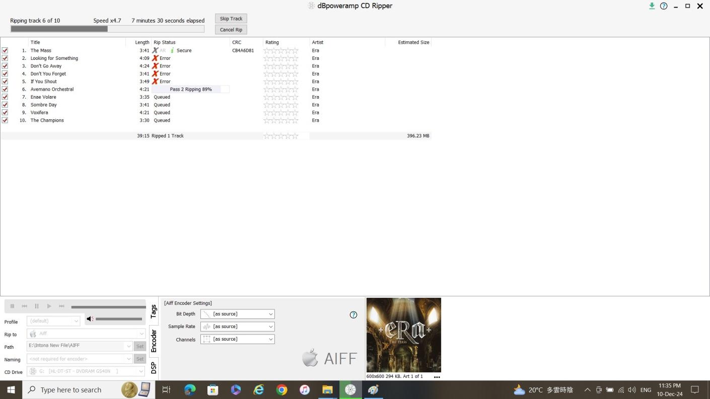

    Unknown Error
ID:	329361 Please advise how to fix my prob lem

    Please advise how can I fix the problem
      • 46078
      After ripping an error page should appear, click copy to clipboard and paste the error messages here
      However it looks like you have ripping errors and you have the option 'Mark insecure rip as Error' checked on the secure ripping page.

        Error ripping to FLAC, 'Track 4' to 'E:\Intona New File\FLAC\Era\The Mass\04 Era - Don't Forget.flac'
        Unable to read CD, check CD disc (frame LBA 55114 ripping 26 frames track end LBA 71713) [clRipperSecure::Rip]
          • 46078
          This is the CD drive not able to read that disc, normally this only happens on very damaged discs.
          Try a different CD, does it rip normally?
          • D Tam
            • Dec 2024
            • 5
            I have tried on other CD, it ripped normally. I have so strange that the problem CD has ripped normally in before.
              • 46078
              Set ripping to Burst mode, does it rip ok?
