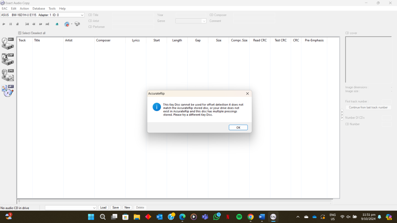

    I have tried to put in any key discs I have at the moment: Pink Floyd, Radiohead, Green Day, Nirvana, Coldplay, Nine Inch Nails, Weezer, Depeche Mode. None of them worked. I only got the 'Communicating with accuraterip: connecting' pop up. Also, my drive which is an ASUS BW-16D1H-U PRO, is not in the AccurateRip list. I also looked at other forums to enable/disable certain options in 'Drive/Offset' and 'EAC' Options just in case, but no such luck. For now, I have manually adjusted the offset of my drive to '+6'.

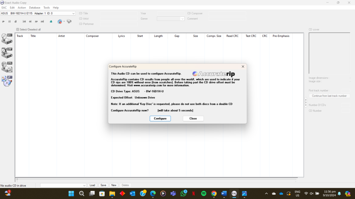

          Spoon I managed to get the pop-up with Coldplay's A Rush of Blood to the Head (the one from the 4CD catalogue set), but likely my drive is not in the database so I kinda failed. I don't have a lot of CDs since I'm a student. I guess it'll take a few years for me to settle this problem.

              Spoon I also managed to trigger the pop-up with Coldplay's Viva La Vida or Death and All His Friends from the same set.

                Yes you need to keep trying different discs

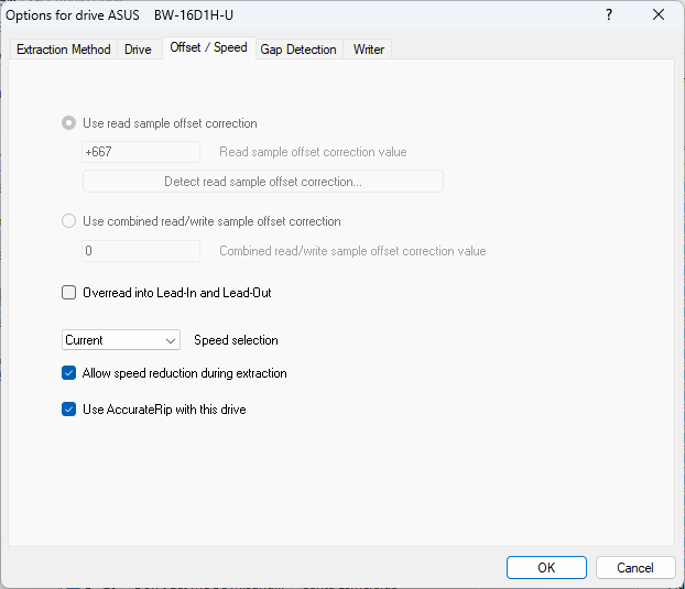

                      Apologies for the bump. I decided to add to this thread, because this is the first hit on Google for this drive and "accurate rip"
                      I was able to provide 3 key disks in Exact Audio Copy and therefore register the drive.
                      EAC detected a +667 read sample offset correction.
                      screenshot of EAC user interface showing the drive details described in this post
