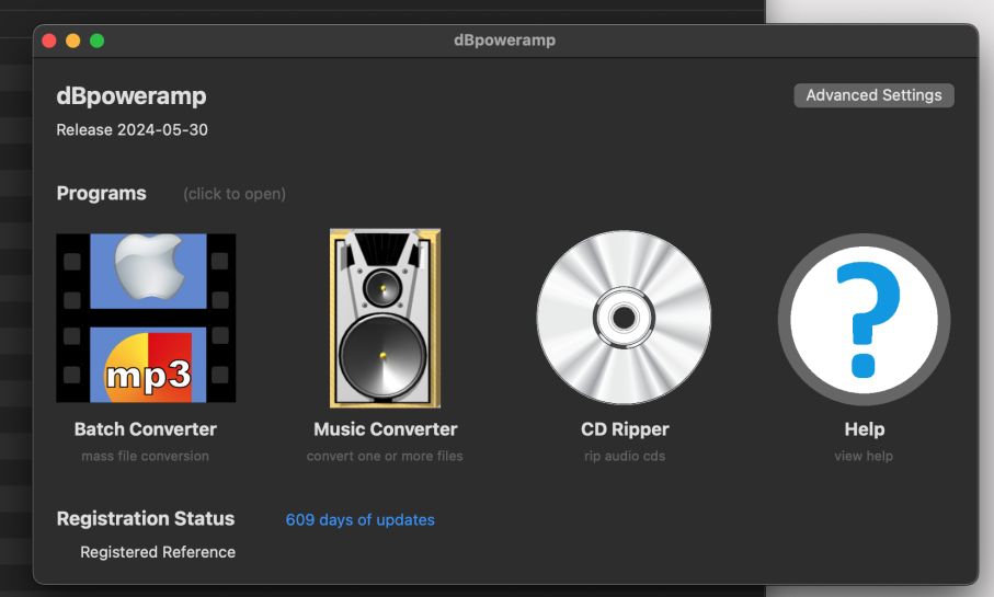

        This is the version I am on, and it is still happening.
          • 46160
          It will be reading the CD from the cache, click refresh to re-read from the internet. If that disc has no metadata in any of the providers, you would still see the above false listing, as it would take from the cache if not present online.
