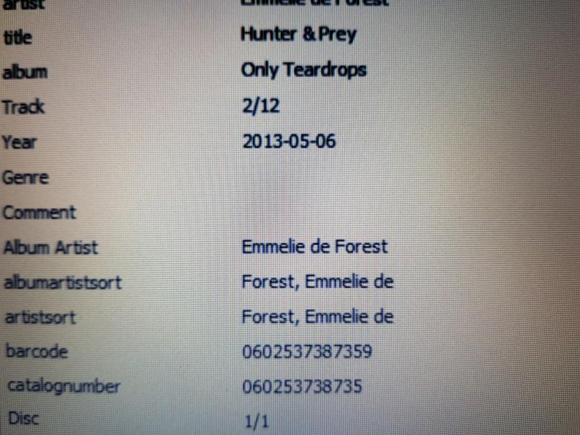

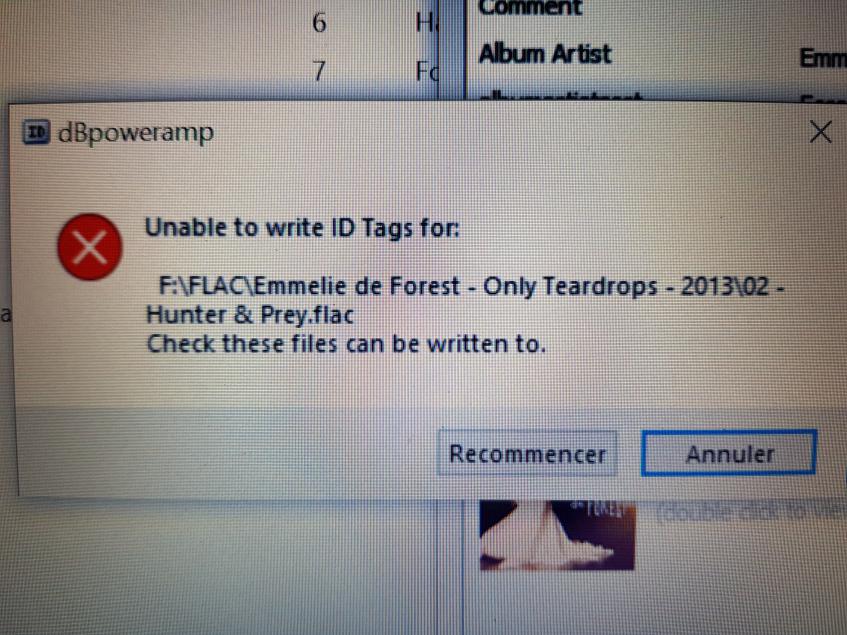

                      Good morning I need help.
                      I have a tagging problem.
                      I can't change the genre of multiple flac files.(see pictures)Click image for larger version
ID:	294263Click image for larger version
                      What should I do?
                      Thank you in advance
                        • 6186
                        Re: help
                        What is the F drive? is it NAS or network drive? If so, perhaps you haven't setup permission to write to that drive.
                        • Emmanuel
                          • May 2015
                          Re: help
                          Good evening,
                          it's an external hard drive.
                          I've been working on this one for a few days with no problem making changes.
                            • 6186
                            Re: help
                            Originally posted by Emmanuel
                            Good evening,
                            look at one of these file's properties and make sure it is not "write protected".
