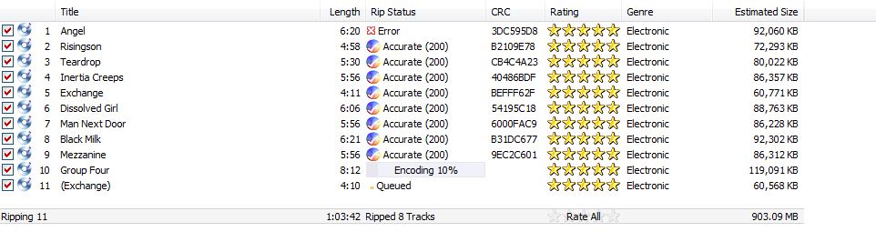

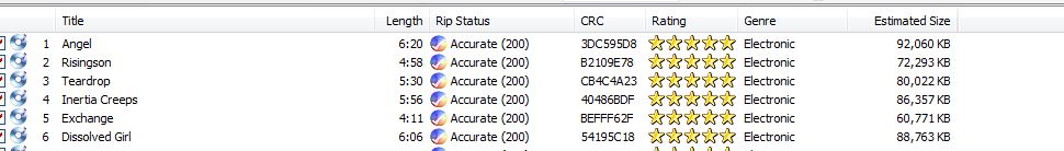

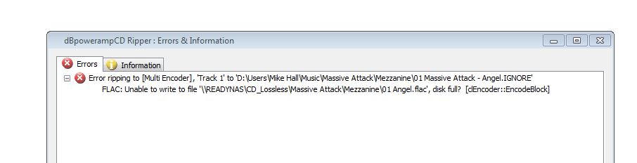

              Just had it happen again, but at least I think I can see the problem now;
              Track 1 errored whilst it was ripping, and produced an error dialog at the end of ripping the whole CD. When I look closely at the dialog I see that in fact it was having trouble writing to my NAS. (I now suspect it is just some latency as the NAS drive first spins up from sleep, which explains why I frequently saw it erroring on Track 1).
              However, when I insert the CD again I get a clean line of ticks and the log file, (attached), shows no errors.
              NB. I am using multi-encoder and I see that the log file is stored with my local rip and is clean, but there is no corresponding log file stored with the NAS's copy and hence that is perhaps why there are no reported errors on re-insertion??

                Re: Insecure tracks automatically securing themselves!
                yes, it is clear that your rips are OK, but the error message you're getting is because it can't WRITE the file to your NAS. In my own case, I rip to my local C:\ drive, and after a ripping session (and I've made sure that I don't need to tweak any tags, etc.), I then move all the new rips over to my network server with my "permanent" music library.
