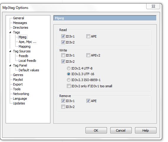

      I'm not 100% sure this will work with mp3tag (because I have no 2.4 files to test) but I suspect it will. load up a few files and test this approach (it will for sure remove the Id3v1 tags).
      1. install mp3tag from here
      2. right click on the column headings bar, choose customize column. Then in the popup, select new. In the new column box, enter NAME = Tag Type and VALUE = %_tag_read%[ (%_tag%)]
      Leave field and sort by empty. Save this, then make sure tag type is ticked on the left so that it shows as a column. This column will show you the tag being read and the other tags in file, e.g.,
      ID3v2.3 (ID3v2.3 ID3v1.1)
      3. go into mp3tag > tools > options > tags > mpeg and set your options to the following:
      4. load up files you want to batch convert into mp3tag, select them all, then hit the SAVE icon (first icon at left of menu bar). Then hit the RED X icon (to the right of SAVE icon). It will ask you if you want to remove the tags. Say OK. If it works you'll still see all your metadata but now the tags will be only ID3v2.3. If it doesn't work (the metadata disappears in the mp3tag columns), then simply hit the "undo" button to the right of the red X.
      If mp3tag won't work, another option is foobar2000. But first try the above (you can simply copy a few files to a new location and test on those first). Once it works, you can load up 1000s of files and do the above and all done. I did this a few years ago to remove all the unnecessary ID3v1 tags.

            aha. Even better option! (does this also remove any existing ID3v1 tag?)
            • McLion
              • Apr 2012
              • 50
              #21
              Re: Corrupt cover art jpeg
              Great!
              I have already downloaded mp3tag but I will try the conversion with dbP first.
              Thank you guys!
                #22
                Yes will remove v1 tag.
