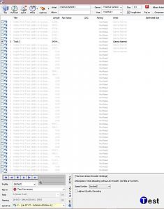

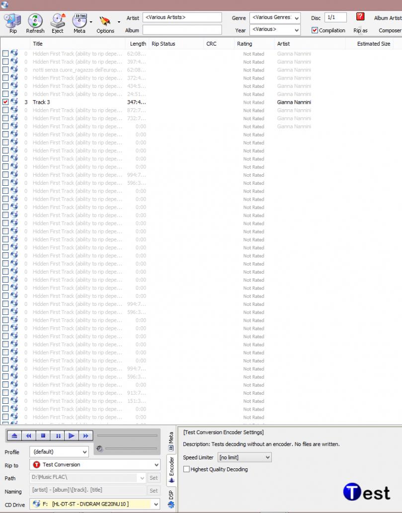

    Having done all this, I have just tried a test rip using the test encoder without any DSP and I have attached the logs. I also seem to find that when I start dBP and there is no disc in the drive I get this very bizarre result that I have attached as a PNG.
