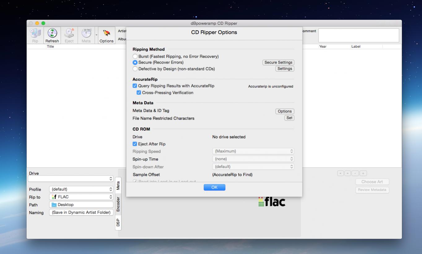

        • paulebarrow
          • Aug 2014
          Re: Mac AccurateRip Configuration
          There is no longer a button to configure. It just says "Accuraterip is Unconfigured"
Name:	Screen Shot 2015-03-10 at 15.13.44.jpg
