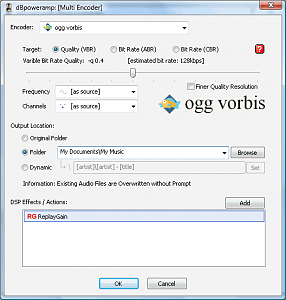

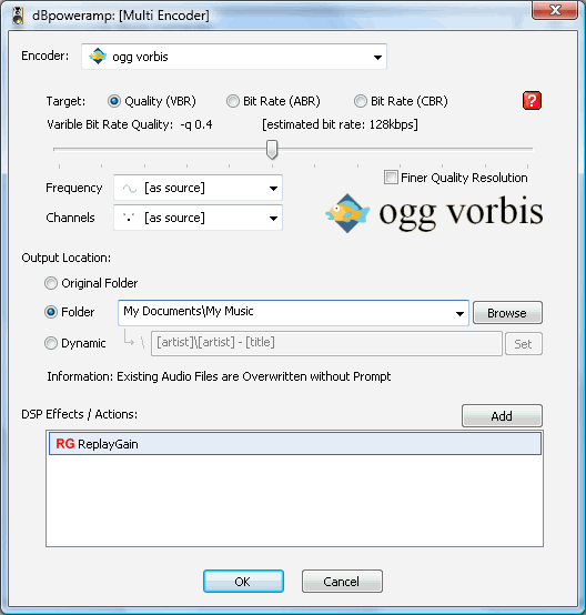

    You should be setting an output location for each encoder, so no, they shouldn't wind up in the same folder. I'm not sure what you mean when you say PATH is grayed out, as the settings dialog box (see below) should look like the Music Converter settings box, where you get three options you can check: Original Folder, Folder (where you then fill or browse to the path), and Dynamic (where you can specify your naming string). There isn't a separate "Path" dialog, button, etc.
    To be clear, select your first encoder from the drop-down box at the top of the Multi-Encoder settings page, then set all the parameters, including output location, for that encoder. Do the same thing for each additional encoder you're using.
