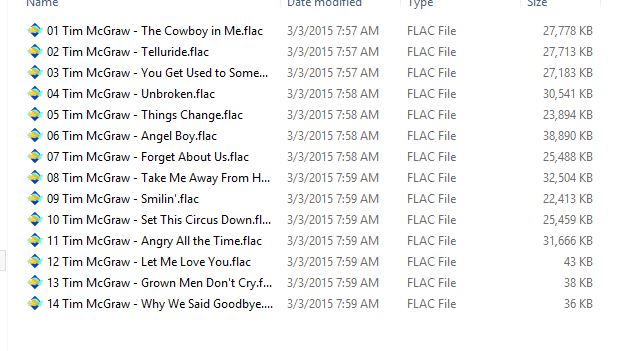

    I'm running secure mode, and sometimes, I'm getting truncated tracks. Anything I should be looking at to help resolve the issue?
    (I'm running the batch ripper, and it's reporting success)
    Here is a screenshot of the folder in Windows Explorer (note the file sizes on the last 3 tracks):

    I've tried several settings, and the same tracks are lost/truncated. Any ideas?

        On a Dire Straits CD - 11 Accurate 1 Secure
        On a Dire Straits CD (On Every Street), the last track (How Long) is only 37Kb in size.
        Really strange... I wonder if the "Secure" tracks aren't being properly processed?

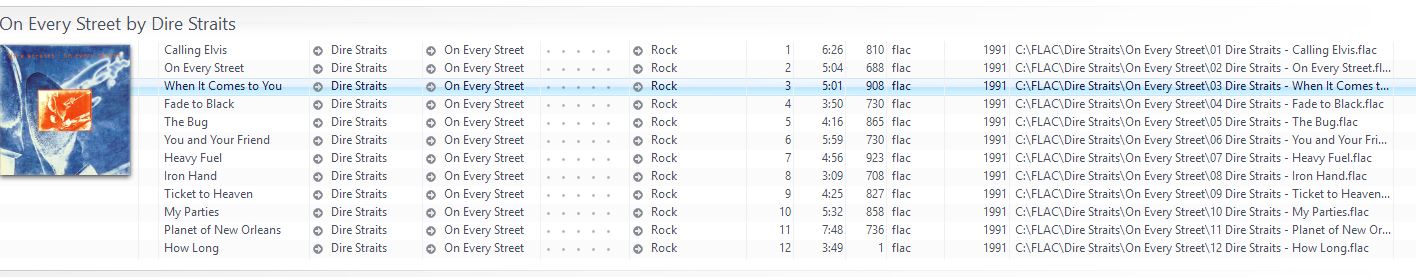

              Here's the Dire Straits info from JRiver. When I play the last song, I get nothing, but all other tracks sound perfect.
              I just did a search on my FLAC folder, and it turns out that 1600 out of 16,000 tracks have this problem :(
