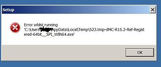

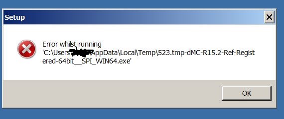

    I've downloaded the new 15.2 version (reference version) to install and get the following error when trying to install (on Win7(64) machine that already has 15.1 installed).
    I've never had any issues before in installing or updating dbpa. I've downloaded the file a few times and tried installing by using "right click, run as administrator". Same error no matter what. Thoughts?
    EDIT: hmmm, I'm getting same error trying to install the CRC DSP as well. I suspect something about my work computer has changed and doesn't like something about how this is being installed. I don't get any AV messages, etc. only the message above in the picture.

    UPDATE. I've now tried on my home laptop (win7(64)) and get the same error message upon install attempt. At home I'm using an up to date "microsoft security essentials" anti-virus program. I've used this for years and not had an issue. I do notice this thread with similar error. But excluding this file within MSE exceptions doesn't solve the problem. And again, there is no AV type error message just the earlier message noted.

                        File is 13.4MB. When I try to run it from the tmp location I get the message: blocked by group policy, contact system admin. I'll have to follow up with our IT folks. Something has probably changed and all my computers are tied to this system. The good news is that the head of IT reports to me. ;-)
