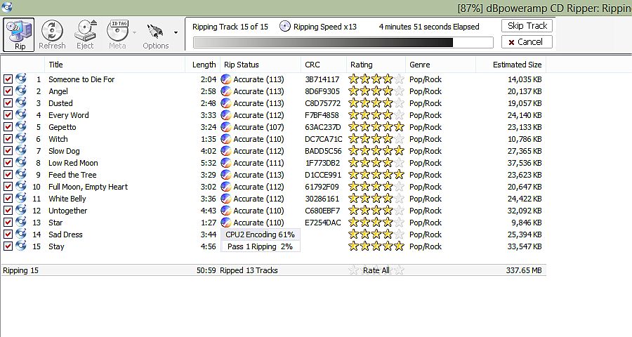

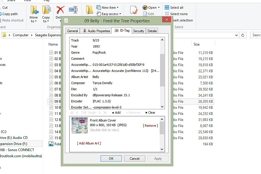

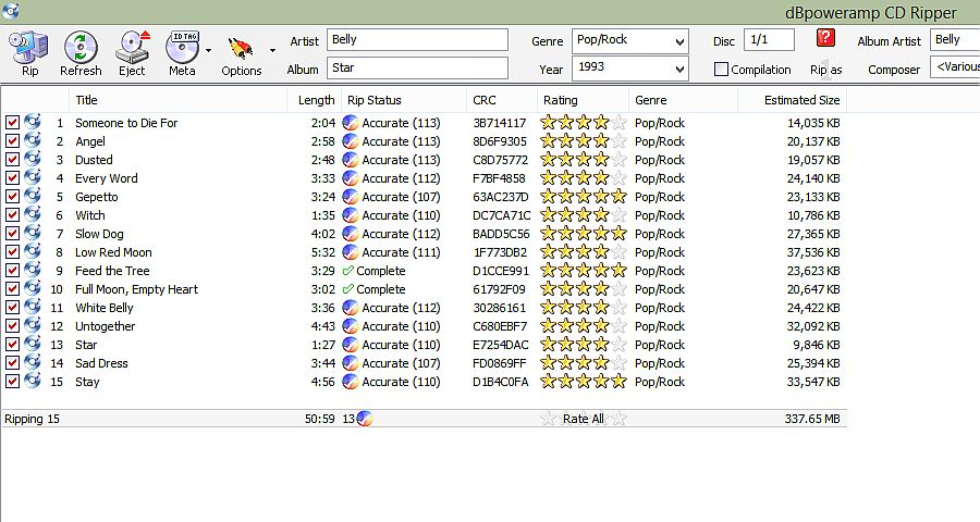

      Of course I couldn't get it to happen for a while, but I finally got screenshots. The first is of the rip at the last track showing all the AccurateRip icons for each track. The second is the screen after the rip is complete showing tracks 9 & 10 with checkmarks. The last shot is of track 9's properties in Windows showing the AccurateRip tag.
      Thanks for looking into this.

        Re: AccurateRip Track Icon Disappears
        It suggests a memory corruption, very strange.
        Try ripping to 'Test Conversion' as the encoder.
        Also show the info log at the end, to display the secure status.
          Here is a test conversion. I ran it a few times before I got the icon to swap. I have new information too. I'm pretty sure it happens when I mess with meta data during the rip. Anyway tracks 1-7 swapped from AccurateRip to Complete.
            Editing the metadata whilst ripping potentially would change the accuraterip values, it is not recommended to do this.
