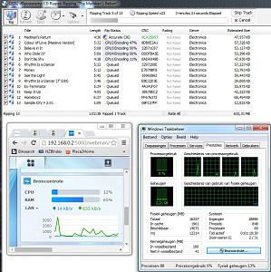

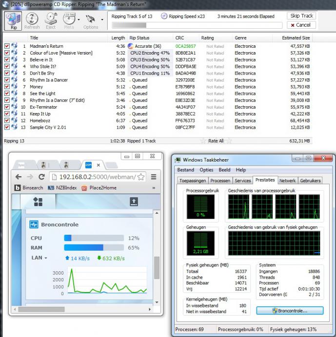

    I've been using CD ripper for quite some time now and succesfully ripped about 300 cd's without a problem. I've always been ripping directly to my Synology DS-212J, and this hasn't slowed me down before.
    Now all of a sudden CD ripper became extremely slow. As shown in the picture the encoding hangs, and this can take up to 10/20 minutes.
    Also shown in the picture that there is no extreme usage in the resources of either the PC nor the NAS.
    Has anyone ancountered this, and found a solution. It must be some setting or something since it worked flawlessly before.

    Try ripping to your local computer as a test, which encoder are you using? Try ripping to Test Conversion as a test.
