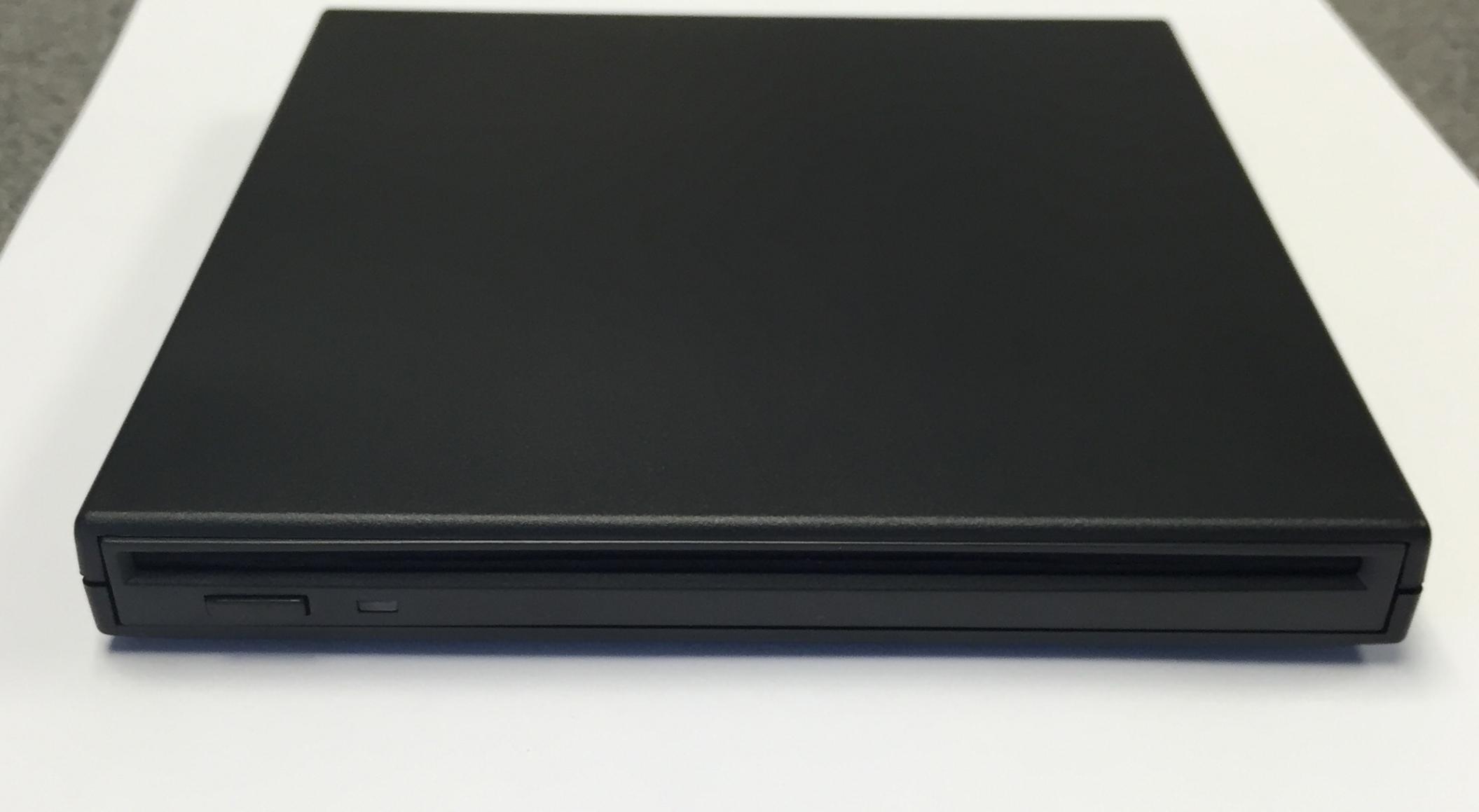

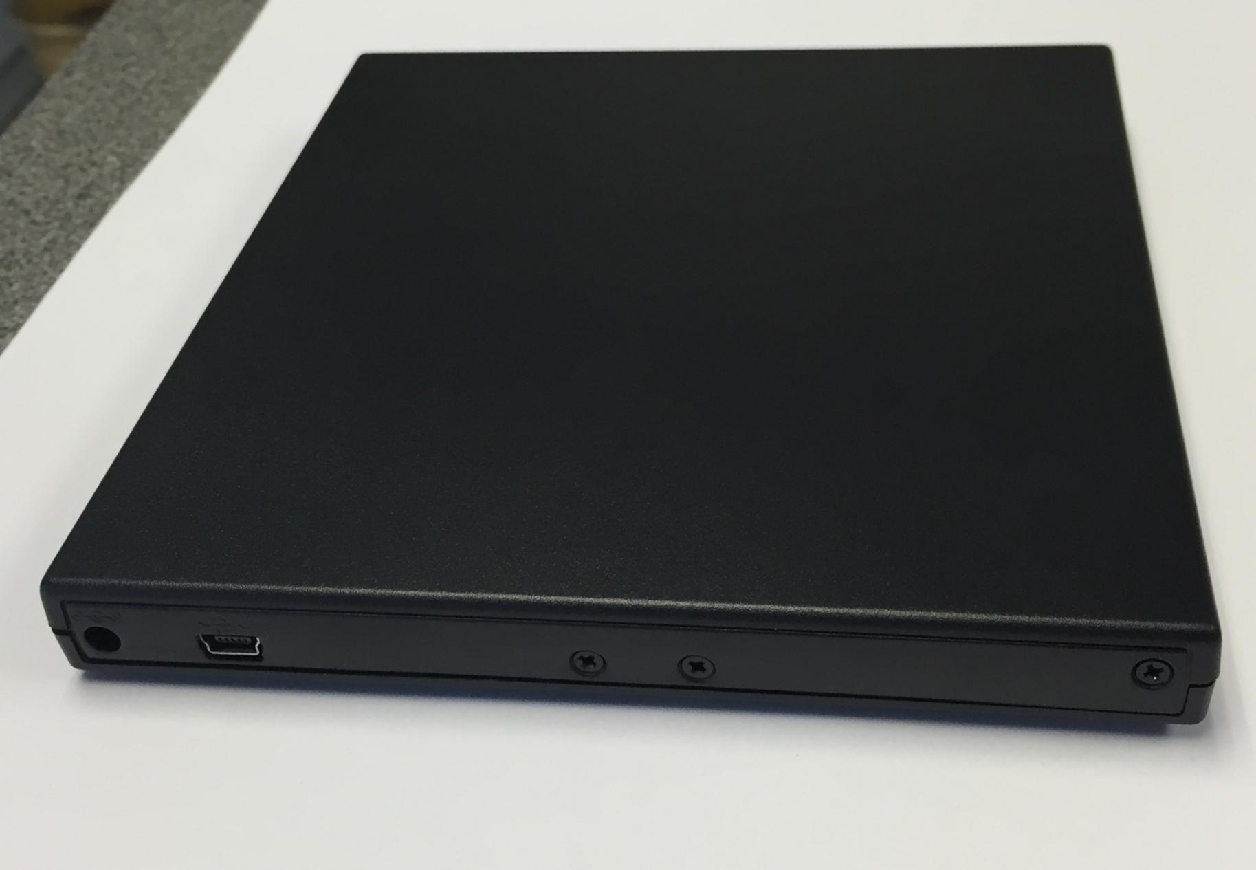

          Re: CD/DVD Drive Accuracy List 2014
          For those who would like to use the highly rated Matshita / Panasonic UJ-85J without much fuss, I recently found a supplier to install a new UJ-85J in an external USB enclosure. The drive I received is an UJ-85J-C old stock from Feb 2007. It seems there were so many manufactured for Apple macbook pro line that there are plenty of new drives still available. The C revision is the typical version and reports simply as UJ-85J to the system. There exists a B revision, but the supplier does not believe there are any other versions.
          The enclosure is a mini ATA/IDE to USB controller and came with dual USB cables for both data and power. I use EAC with a test music CD reporting positive results from AccurateRip. So far, this UJ-85J over USB has tackled a difficult collection of short stories on CD where my stock laptop drive couldn't tackle the last track on each disc.
          For the USB enclosure:
          Use the MCE email contact link, or try Arnie at: arnie@mcetech.com
          Arnie installed the drive in a black version of the enclosure, including a nice bezel with spiffy priority shipping. He warned me that the eject button would not function and discs must be ejected by the system instead. All around fantastic service with a reasonable price.
ID:	293034Click image for larger version
