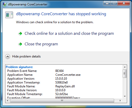

    Good afternoon,
    I recently upgraded to R15 the other day. When a CD rips completely I have no problems, but if I cancel the rip or it automatically aborts (having it set on cancel if it rips an inaccurate track) then I receive the following error:
    "dbPoweramp CoreConverter has stopped working"
    Code:
    Problem signature:
      Problem Event Name:	BEX64
      Application Name:	CoreConverter.exe
      Application Version:	15.0.0.10
      Application Timestamp:	530610e0
      Fault Module Name:	ReplayGain.dll
      Fault Module Version:	10.0.0.0
      Fault Module Timestamp:	52cbf2be
      Exception Offset:	000000000002aecc
      Exception Code:	c0000417
      Exception Data:	0000000000000000
      OS Version:	6.1.7601.2.1.0.256.1
      Locale ID:	1033
      Additional Information 1:	1355
      Additional Information 2:	13558394bbd43eeaf946e812134b6624
      Additional Information 3:	f358
      Additional Information 4:	f35856d0c73ef2562c2e078e9b81d5e7
    The error seems to indicate that it's an issue with the ReplayGain.dll, which makes sense seeing as how I have that DSP effect enabled. I've been able to hack the error away by using this regedit tweak to windows.
    It doesn't seem like a major problem, seeing as how the program stopped working due to it being aborted... But still I wanted to bring it to your attention. If anyone has any ideas on how to properly fix this issue, I'd be happy to try a few out.

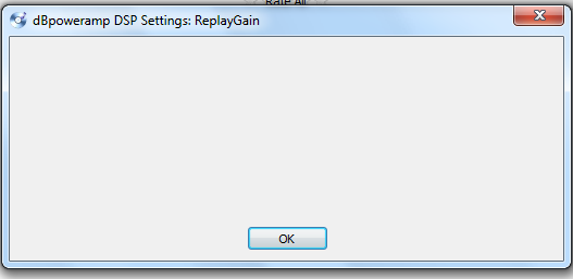

        Just got around to testing this now. Unfortunately it looks like it didn't work. Uninstalled old DSP effects and tried out this beta. The ReplayGain window is blank, aside from the "Ok" button at the bottom. See here: Click image for larger version
        Furthermore, any other DSP effect that I select shows a similar sort of blank screen.
        Anyway, I wanted to push forward. I cancelled the rip manually a few tracks through to attempt to replicate the error I was receiving when I started this thread. All tracks are marked as errors in the "dBpowerampCD Ripper : Errors & Information" dialog that appears post-rip. The error is:
        Error: Unable to load DSP Effect 'ReplayGain'. [dbCoreConverter::LoadDSPEffects]
        Thank you for the quick response earlier. I'm rolling back to DSP Effects R10 for the time being, but I'd be happy to try out any other betas that you have to solve this problem. Finally, if you would rather me continue this thread on the one you linked earlier just let me know.
