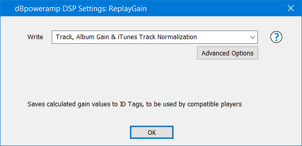

      i am using the default replay settings, pls could you guide if is ok. pls find attached screen shot. Click image for larger version

      what does one use if not using iTunes ?? could you suggest a setting, please.

        #33
        Re: Replay Gain - Settings
        Those settings are fine, even if not using iTunes.
