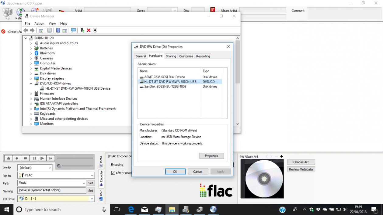

    hello Spoon,
    Similar issue to threads here... dbpoweramp does not "see" the CD Drive as it is simply shown as "D:[-]" in bottom left-hand of screen, whereas usually this shows the name/type of the CD Drive. CD's do rip, just that Accuraterip does not work.
    Setup:
    New HP Pavilion running Windows 10 and with external USB CD ROM connected to 3.0 port (as no internal drive). Device Manager shows the DVD/CD ROM name/type as "HL-DT-ST DVD-RW/GWA-4080N" per attached picture.
Name:	dbpoweramp CD drive name not found.jpg
    Ran the "debugger" with result as follows:

    Drive D: is the CD Drive, E: is "Recovery", and F: is a USB HDD.
    Other comments:
    dbpoweramp does "see" the CD Drive as I changed the drive letter to "G:" and this changed on the screen - just the name/type is missing.
    Tried "naming" the CD Drive under the Options and CD Drive [Technical] but the data is not saved.
    Would appreciate advice, thanks, Steve.

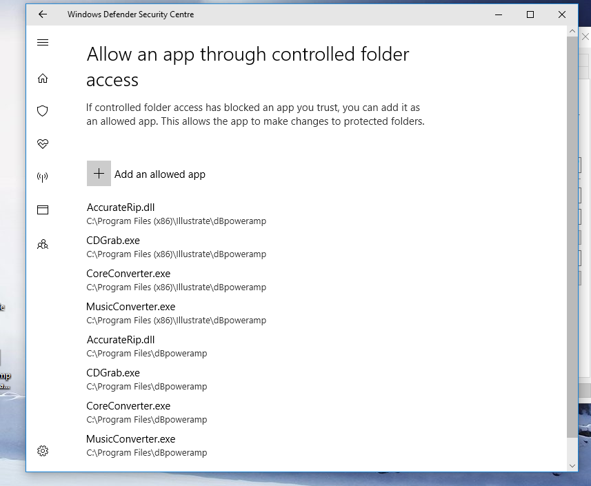

                      First good news, both R14.x (paid) and R16.x (temp.) seem to work now and are ripping & reporting via Accuraterip, even though the CD Drive is still not "named" and shows as "D:[-]" - this was a red herring. Think it was due to the dbpoweramp App not being "allowed through a controlled folder" by Win Defender. This option just came up (didn't previously) and I've enabled several files including CDGrab.exe of both versions. The Accuraterip also then self-configured. Have ripped 2 CD's several times and all okay.
                      BTW I did try the Win Safe mode but that made no difference, other than after restarting in Normal mode Win Defender gave this "allow through" option.
                      Thus for reference it looks as if Win Defender was the issue, and I attach the debug output and a screen-shot of the option itself.debug1.txtClick image for larger version
Name:	allow through.png
                      Thanks for your help.
