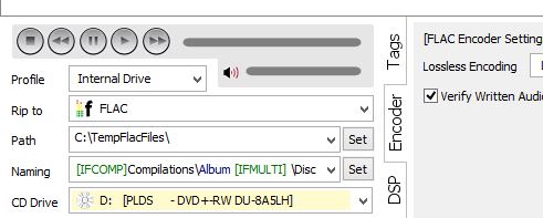

                          I now have an external drive which doesn't support C2 detection (SATA connection so I don't think it works), whilst my internal one does. I can change the settings for the C2 Ultra Passes, but it then sets that for the internal drive too, so unless I keep changing the settings each time I use a different drive, I'm not sure what to do with this. Any advice what to do other than continually changing the settings as and when I use each drive? Or I suppose I could just use the new external drive for ripping CDs, but I might sometimes want to try a disc with the internal drive.

                            • 6186
                            Re: C2 Error Pointers
                            You can save ripper settings separately for each drive. Give each a different profile name, and then just choose the profile you want. See:

                            • Hotdog
                              • Nov 2015
                              • 52
                              Thanks, I've done that. Of course, it doesn't automatically switch to the different profile when a certain drive is used - I assume. So I have to remember to switch between profiles if I'm using a different drive.
