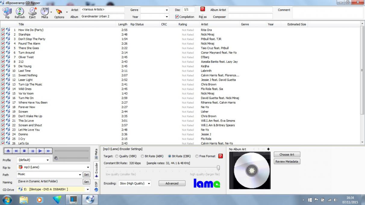

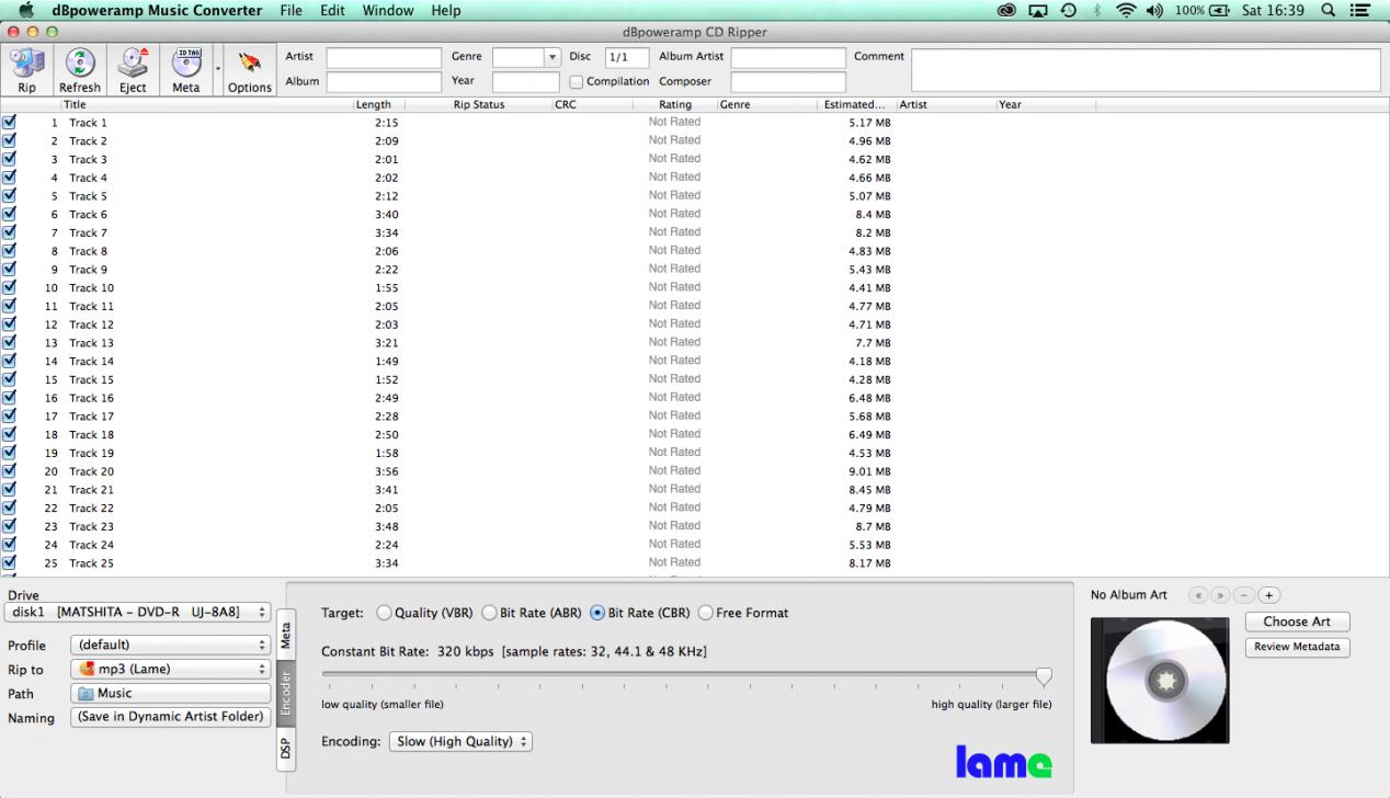

                              I really can't along with these issues I'm having with Mac and dbpoweramp. I understand from my own thread that for random reason, the CD Text reader can't pick up the text from CD's (although someone has made a fix for iTunes to do it if iTunes doesn't find the CD's and it works fine)
                              This rip as one is different too.... Mac Pro, no button on full screen. On Windows, there it is!!!! The Mac is running 15.2 and windows is running the older version of 14.4
Name:	dppa windows.jpg
Name:	Screen Shot 2015-11-07 at 16.39.04.jpg
