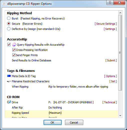

                      hi .. I'm not sure if this is under the correct thread ... I was ripping a CD with 16 tracks ... and all are ripped well except the 10th track ... pls find attached the error report.log.txt
                      would appreciate any assistance ...

                        Your log shows that all 16 tracks are verified with accuraterip, including track 10. Why do you think there is an error. Did you copy the files somewhere else after ripping? If so, could be corruption when copying.
                          hi, thanks .. yes, I notices that too .... pls find attached my setting. all my ± 100 CDs are ripped ok .. this particular CD is ripped with the same error message twice ... Click image for larger version

                            Settings are fine. You have not posted anything showing an error. What you posted showed that the cd ripped with no errors.
