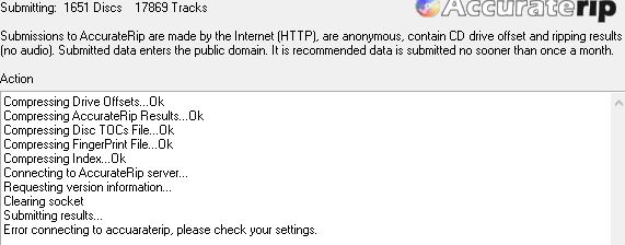

            I ran into the same problem and solved it in the same way - submitted less data.
            But this is not really a satisfactory solution. Can't the server be changed to accept more data?

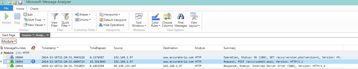

            I found Microsoft's Message Analyzer on the web and although this is my first time using it, I found that it shows an error 500 on the accuraterip server:
            If the server can't be fixed, maybe you can at least modify the error message to say that there's too much data instead of there is no connection and something is wrong with the settings.
