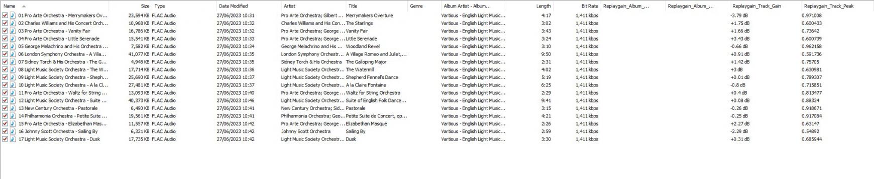

          Thanks @simbum and @garym
          I'm a bit confused now.
          Ignoring the original question I asked above about old MP3 tracks, can I ask if I have ripped my albums correctly?
          Having bought the software a couple of months ago I set the Ripper up as per the instructions - secure mode, offset, CD with triangular bit blacked out, FLAC Level 5 Compression etc. and started ripping my 900ish albums - a task I only completed a few days ago.
          I've recently bought a Naim Atom HE and have copied all the ripped albums to a 1TB USB that is plugged into the Atom.
          The DSP Replay Gain (Track Gain) appeared in the DSP window by default and on the face of it seemed to be just what I needed.
          If listening to a mixed playlist I'm forever having to adjust the volume up or down for many tracks (95% classical music) which is really annoying and the Replay Gain seemed to be just what I needed.
          So I've ripped all my albums with the Replay Gain (Track Gain) DSP setting.
          Have I screwed up?
          And if I have, how should I do it correctly for the best possible quality.
          I've attached a shot of the TAGS-
            Re: Can I apply DSP Replay Gain to files that have already been ripped?
            Have I screwed up?
            [ATTACH=CONFIG]3571[/ATTACH]
            No, you simply added RG tags and your audio is unchanged. So you are good! I do exactly the same thing when ripping except I change the settings of the RG DSP to add both TRACK and ALBUM RG tags.
