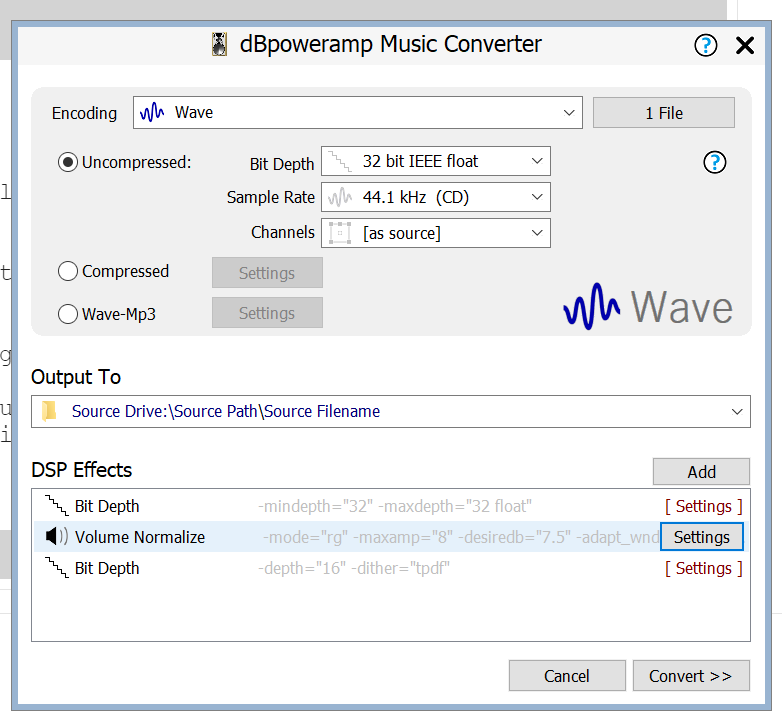

    I have chosen 3 DSP's
    Right click convert to wav with bit depth set to 32 bit float (I have read if manipulating volume you have to do this with 32 bit float, although the settings available are 32 bit or 32 bit IEEE float (i have no idea what the IEEE is, but since that is the only option with the float word, that is what I was choosing.
    Then, second DSP is volume normalize using either ReplayGain Track gain set to either -6.6 or -7.5 (I use MediaMonkey and those numbers are what I see when I analyze volume.
    Then the 3rd DSP is bit depth again to take back down to 16 (I have not manually increased bit rate or depth because I was assuming using the 32 bit float does that automatically, so I need to bring it back down, and was told use triangular dither back to 16.

            I have no idea about the static. dbpoweramp conversions, adding RG tags, etc. should not add any static to the tracks. Have you listened to the tracks on different players? Maybe your player is adding the static, but the files are just fine. And are you saying there is no static on the files BEFORE you do volume normalization? And talking to Dell (or Apple, etc.) support will likely provide ZERO value. They will have no clue and just blame the files.
            My only thought is that the conversion to 32 bit and then downconverting to 16 bit is the only possible spot where I could see any possibility of a problem. Try to do your volume normalize WITHOUT doing the 32 bit conversion. Just take your 16 bit files, make sure they have correct RG tags (run though the RG dsp as I already explained), and then do the volume normalize step. Does this still produce static.

              I did take your advice and first ran them thru to freshen up the gain and peak tags, then changed it to just 16bit with the only DSP being the Vol.Norm. with the EBU Track gain and it seems to have eliminated the static. And here I was trying to do all of my research and learn all the ultimate correct ways to do it, and the easiest and most basic worked. I wish I could find the exact thread explaining that you should only run any or most DSP's while it is in a 32bit float "state" since I don't know the musical technical term.
