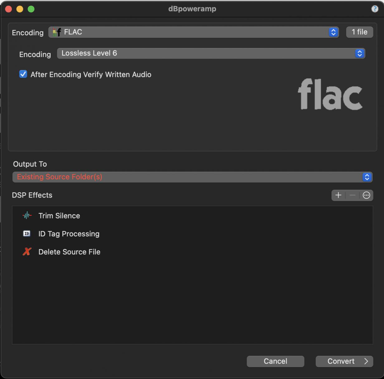

    Although there's a little bit more under the hood than this photo suggests, my default lossless batch converter currently looks like this:
Name:	Screen Shot 2022-06-20 at 01.55.39.jpg

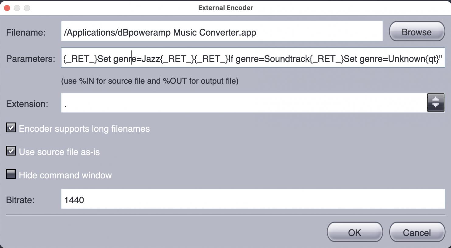

    and so far my JRMC external encoder's settings currently look something like this:
Name:	Screen Shot 2022-06-20 at 02.27.54.jpg
    I've done some research on the topic of using DBPoweramp as an external encoder in JRMC which unfortunately has only brought up questions for me. In this article about command line encoding for PC with DBPoweramp, an .exe called CoreConverter.exe is mentioned as an ".exe path" but I haven't been able to find CoreConverter.app on my Mac and so instead I set the external encoder path as "dBpoweramp Music Converter.app". Is this the correct path that I need?
    I've also started writing the "Parameters" which I pieced together from old posts about this topic as well as my saved .dspeffect files (I can't run regedit.exe as per the command line article) and so my Parameters currently look like this:
    -infile=%IN -outfile%OUT -convert_to="FLAC" -dspeffect1="Trim Silence=-dbsilence={qt}-80{qt} -threshold={qt}1{qt}" -dspeffect2="ID Tag Processing=-add0={qt}Comment=DBPoweramp{qt} -exportart={qt}(none){qt} -importart={qt}(none){qt} -maxart={qt}(any){qt} -maxartkb={qt}(any){qt} -removemonthdayfromyear -charreplacement={qt}(Disc 1){_RET_}(Disc One){_RET_}(Disc 2){_RET_}(Disc Two){_RET_}(Disc 3){_RET_}(Disc Three){_RET_}(Disc 4){_RET_}(Disc Four){_RET_}(Disc 5){_RET_}(Disc Five){_RET_}(Disc 6){_RET_}(Disc Six){_RET_}(Disc 7){_RET_}(Disc Seven){_RET_}(Disc 8){_RET_}(Disc Eight){_RET_}(Disc 9){_RET_}(Disc Nine){_RET_}(Disc 10){_RET_}(Disc Ten){_RET_}(Disc 11){_RET_}(Disc Eleven){_RET_}(Disc 12){_RET_}(Disc Twelve){_RET_}(Disc 13){_RET_}(Disc Thirteen){_RET_}(Disc 14){_RET_}(Disc Fourteen){_RET_}(Disc 15){_RET_}(Disc Fifteen){qt} -rulemap={qt}IF genre=Hip-Hop/Rap{_RET_}Set genre=Hip-Hop{_RET_}{_RET_}IF genre=Hip Hop/Rap{_RET_}Set genre=Hip-Hop{_RET_}{_RET_}IF genre=Rap{_RET_}Set genre=Hip-Hop{_RET_}{_RET_}IF genre=Hard Rock{_RET_}Set genre=Rock{_RET_}{_RET_}IF genre=Electro{_RET_}Set genre=Electronic{_RET_}{_RET_}IF Genre={_RET_}Set Genre=Unknown{_RET_}{_RET_}IF Album Artist={_RET_}Set Album Artist=[artist]{_RET_}{_RET_}IF genre=House{_RET_}Set genre=Electronic{_RET_}{_RET_}IF genre=Techno{_RET_}Set genre=Electronic{_RET_}{_RET_}IF genre=Ambient{_RET_}Set genre=Electronic{_RET_}{_RET_}IF genre=Rap/Hip Hop{_RET_}Set genre=Hip-Hop{_RET_}{_RET_}IF genre=Rap/Hip-Hop{_RET_}Set genre=Hip-Hop{_RET_}{_RET_}If genre=Hardcore Hip-Hop{_RET_}Set genre=Hip-Hop{_RET_}{_RET_}If genre=Hardcore Hip Hop{_RET_}Set genre=Hip-Hop{_RET_}{_RET_}If genre=Hardcore Rap{_RET_}Set genre=Hip-Hop{_RET_}{_RET_}If genre=Hip Hop{_RET_}Set genre=Hip-Hop{_RET_}{_RET_}IF genre=Alternative & Indie{_RET_}Set genre=Rock{_RET_}{_RET_}IF genre=Alternative{_RET_}Set genre=Rock{_RET_}{_RET_}IF genre=Smooth Jazz{_RET_}Set genre=Jazz{_RET_}{_RET_}If genre=Jazz/Bop{_RET_}Set genre=Jazz{_RET_}{_RET_}If genre=Bop{_RET_}Set genre=Jazz{_RET_}{_RET_}If genre=Soundtrack{_RET_}Set genre=Unknown{qt}"
    My question regarding this is how do I specify within these parameters that I want to encode lossless files as FLAC files with encoding level 6 and to verify the written audio after encoding (like in my first screenshot)? On a side note, how can I determine the encoding level of a FLAC file? Does it matter if the lossless conversion occurs before or after my DSP effects? Am I missing anything in JRMC's external encoder settings such as under "Extension:" or "Bitrate:"? JRMC seems to require a value under "Extension:" and so is "-convert_to="FLAC"" under "Parameters" even necessary? Please help me! So far all of my combinations and attempts in JRMC have resulted in failed conversions.

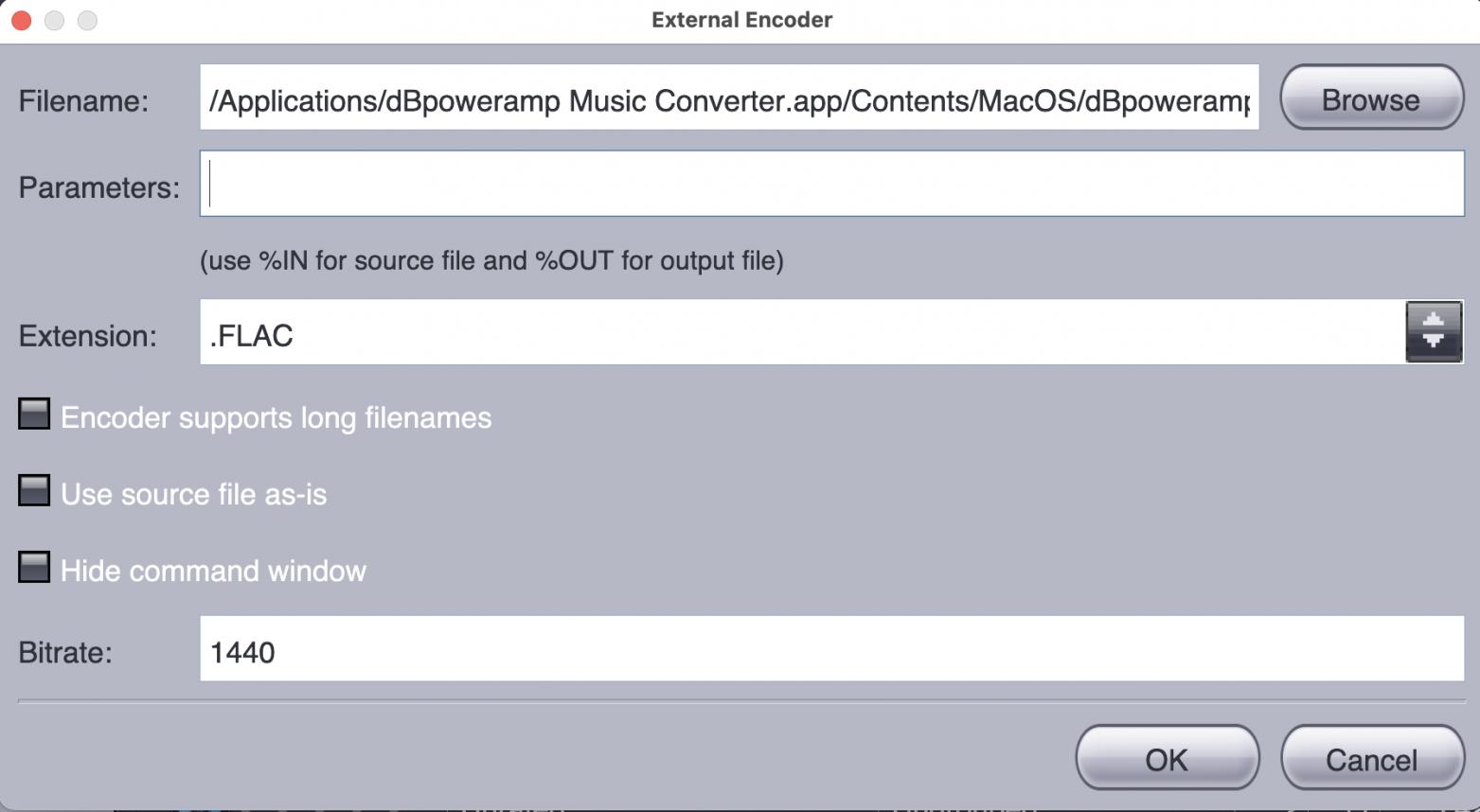

          Could this be inputted into JRiver's external encoder then (which looks like this)?:
Name:	Screen Shot 2022-10-18 at 18.47.01.jpg
          I think the answer is yes so I've started writing the code but I have some questions. What do I put as the external encoder path in JRiver? I figured it might be "/Applications/dBpoweramp\ Music\ Converter.app/Contents/MacOS/dBpoweramp\ Music\ Converter" but that isn't working. Do I need to target the Music Converter.app and if so how do I do that? If I want the infile and outfile to be the source file's original location (and folder) then how do I write that (or should I exclude the infile and outfile given the following JRiver options)? Do these mandatory options of JRiver's for the external encoder conflict with DBPoweramp's infile and outfile code (specifically the JRiver settings highlighted in red boxes)?:
Name:	Screen Shot 2022-10-18 at 19.27.16.jpg
          Here is what the code currently looks like:
          Code:
          /Applications/dBpoweramp\ Music\ Converter.app/Contents/MacOS/dBpoweramp\ Music\ Converter -coreconverter -infile="/path/to/myfile" -outfile="/path/to/newfile" -convert_to="FLAC" -dspeffect1="Trim Silence=-dbsilence={qt}-80{qt} -threshold={qt}1{qt}" -dspeffect2="ID Tag Processing=-add0={qt}Comment=DBPoweramp{qt} -exportart={qt}(none){qt} -importart={qt}(none){qt} -maxart={qt}(any){qt} -maxartkb={qt}(any){qt} -removemonthdayfromyear -charreplacement={qt}(Disc 1){_RET_}(Disc One){_RET_}(Disc 2){_RET_}(Disc Two){_RET_}(Disc 3){_RET_}(Disc Three){_RET_}(Disc 4){_RET_}(Disc Four){_RET_}(Disc 5){_RET_}(Disc Five){_RET_}(Disc 6){_RET_}(Disc Six){_RET_}(Disc 7){_RET_}(Disc Seven){_RET_}(Disc 8){_RET_}(Disc Eight){_RET_}(Disc 9){_RET_}(Disc Nine){_RET_}(Disc 10){_RET_}(Disc Ten){_RET_}(Disc 11){_RET_}(Disc Eleven){_RET_}(Disc 12){_RET_}(Disc Twelve){_RET_}(Disc 13){_RET_}(Disc Thirteen){_RET_}(Disc 14){_RET_}(Disc Fourteen){_RET_}(Disc 15){_RET_}(Disc Fifteen){qt} -rulemap={qt}IF genre=Hip-Hop/Rap{_RET_}Set genre=Hip-Hop{_RET_}{_RET_}IF genre=Hip Hop/Rap{_RET_}Set genre=Hip-Hop{_RET_}{_RET_}IF genre=Rap{_RET_}Set genre=Hip-Hop{_RET_}{_RET_}IF genre=Hard Rock{_RET_}Set genre=Rock{_RET_}{_RET_}IF genre=Electro{_RET_}Set genre=Electronic{_RET_}{_RET_}IF Genre={_RET_}Set Genre=Unknown{_RET_}{_RET_}IF Album Artist={_RET_}Set Album Artist=[artist]{_RET_}{_RET_}IF genre=House{_RET_}Set genre=Electronic{_RET_}{_RET_}IF genre=Techno{_RET_}Set genre=Electronic{_RET_}{_RET_}IF genre=Ambient{_RET_}Set genre=Electronic{_RET_}{_RET_}IF genre=Rap/Hip Hop{_RET_}Set genre=Hip-Hop{_RET_}{_RET_}IF genre=Rap/Hip-Hop{_RET_}Set genre=Hip-Hop{_RET_}{_RET_}If genre=Hardcore Hip-Hop{_RET_}Set genre=Hip-Hop{_RET_}{_RET_}If genre=Hardcore Hip Hop{_RET_}Set genre=Hip-Hop{_RET_}{_RET_}If genre=Hardcore Rap{_RET_}Set genre=Hip-Hop{_RET_}{_RET_}If genre=Hip Hop{_RET_}Set genre=Hip-Hop{_RET_}{_RET_}IF genre=Alternative & Indie{_RET_}Set genre=Rock{_RET_}{_RET_}IF genre=Alternative{_RET_}Set genre=Rock{_RET_}{_RET_}IF genre=Smooth Jazz{_RET_}Set genre=Jazz{_RET_}{_RET_}If genre=Jazz/Bop{_RET_}Set genre=Jazz{_RET_}{_RET_}If genre=Bop{_RET_}Set genre=Jazz{_RET_}{_RET_}If genre=Soundtrack{_RET_}Set genre=Unknown{_RET_}{_RET_}If user={_RET_}Set user=New Library{_RET_}{_RET_}If grouping={_RET_}Set grouping=Ungrouped{qt}" -dspeffect3="Delete Source File=-recycle -removeemptyfolders" -compression-level-6 -verify
          I'm going to begin testing and experimenting with some of the code to see if I can get it to work. I'll update this comment with more questions as they come up. Thanks again and I look forward to hearing from you.
