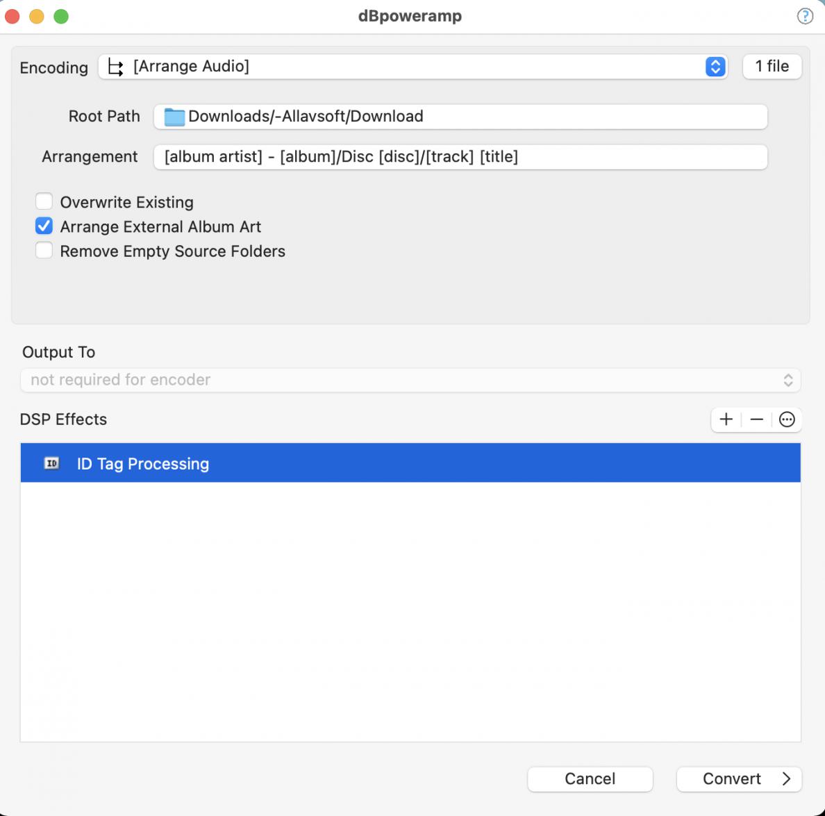

    Hello DBPoweramp Support Forum,
    I'm trying to devise an [Arrange Audio] arrangement scheme through Batch Converter that would allow me to create a folder structure that would only add disc folders to said structure if I'm converting a multi-disc album (I assume this would be done with a programmable action such as [IFMULTI] but I don't know exactly how I'm supposed to write it). Here's what I have so far: [album artist] - [album]/Disc [disc]/[track] [title]
    I've tried innumerable combinations of banging my head against the wall but am about to pass out. Can someone please advise me on how to proceed?
    The other conversion I'm trying to accomplish is using the "ID Tag Processing" DSP Effect to add "(Disc *)" to the album tag. I also haven't gotten anywhere with this but have tried different combinations with rule based manipulation, mapping, and additions but to no avail. Any help would be appreciated.
    Also, are there any guides that could provide some direction as to how to do this stuff so I can try to mitigate pestering this forum in the future?
    Regards,
    John

    Try:
    [album artist] - [album]/[IFMULTI]Disc [disc]/[][track] [title]
      Hey Spoon, this did the trick for arranging multi-disc albums into folders "Disc 1", "Disc 2", etc and also not creating disc folders for single disc albums, which will make my life a lot easier. Thank you for your help. I was off by the "[]" you put to the left of "[track]" - what does "[]" do?
      Is there a way to also add the disc numbers (i.e., "Stadium Arcadium (Disc One)") to the album ID tags for multi-disc albums within this same [Arrange Audio] process?

          Re: Using [Arrange Audio] to Organize and ID Tag Batches of Audio Files
          [] closes the [IFMULTI] statement

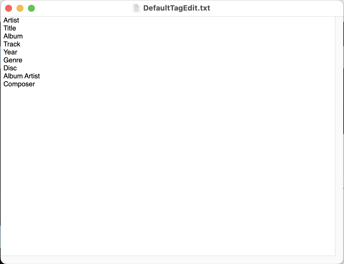

            I tried your suggestion regarding adding "(Disc 1)" to the album tags but it didn't work with either my Lossless Converter profile or Arrange Audio. I couldn't find any conflicting settings in any of the other preference settings. I recently tried to simplify my "Default Tag Edit Fields"; could this have something do with why it's not adding (Disc x) to the album tag?:
Name:	Screen Shot 2022-03-21 at 12.15.46.png
            I'm also using FLAC. I don't know if that changes anything regarding my tagging capabilities.
