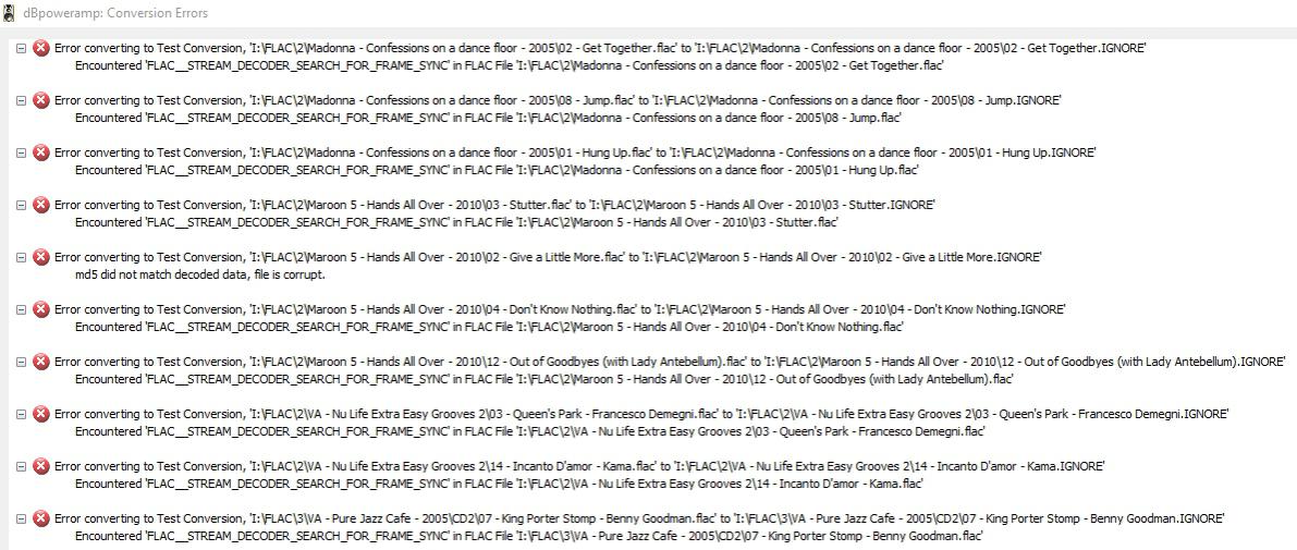

    On one old drive I did a test conversion of FLAC files, below is a message I have received at the end, I would appreciate if
    someone can explain what could be the reason of the error.
    I have tried to play the files, and everything is OK I did not hear any issues.

    Try using dBpoweramp to convert one of those FLAC to Flac (without overwriting the existing).
    I am thinking they are corrupted.

      Re: Test conversion - Meaning of the error message
      OK, I'll try... if still receive the error m. file is corrupt and there is no remedy?

        Different players use different FLAC decoding libraries, FB2000 uses ffmpegs which might be able to decode the files. We use the official FLAC release.

          OK thanks, I did not played this flac files for long time, do you know what can make them go corrupt?

            Bad disk (HDD or SSD), or perhaps they were created by a program which did not write them correctly.

              Tried Foobar same thing, files are corrupt.
